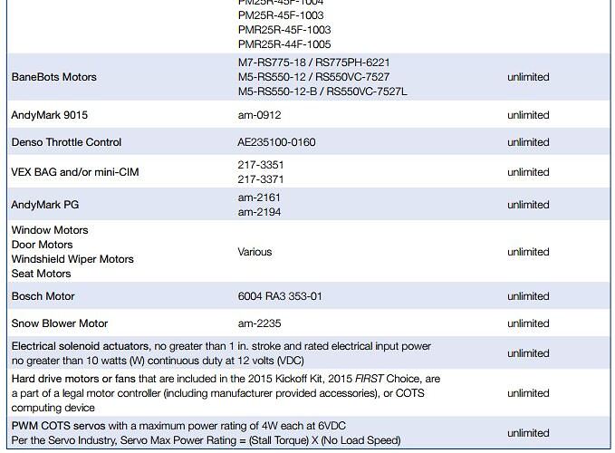

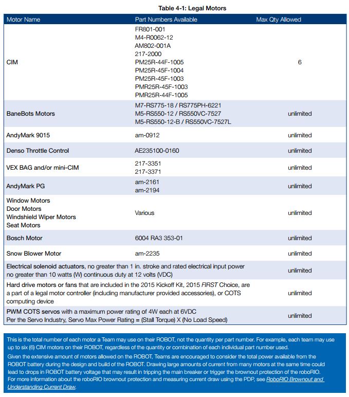

…you are aware that there are restrictions on what motors teams are allowed to use in FIRST, correct?
[quote=“R18”]
R18 The only motors and actuators permitted on 2015 FRC ROBOTS include the following:
[/quote]
