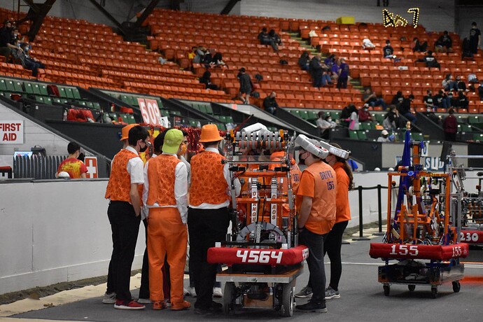

4564 Orange Chaos has a motorized cart that I believe is built on the base of a motorized wheel chair. Image stolen from their facebook page.

Team 696 has a scissor lift motorized cart that I think is really cool. The only downside to the cart was you couldn’t push it unless you used the motors.
To quote the changes to the event rules for 2024,
First, motorized carts (i.e. carts with powered propulsion) will not be allowed to be used at events. These carts create safety hazards as the driving could become uncontrolled in potentially crowded areas. This rule is not meant to disallow carts with motorized lifts.
That is team 5006
