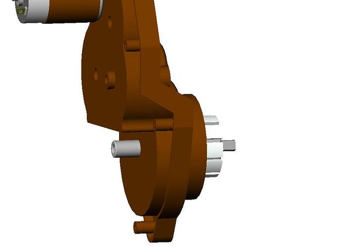

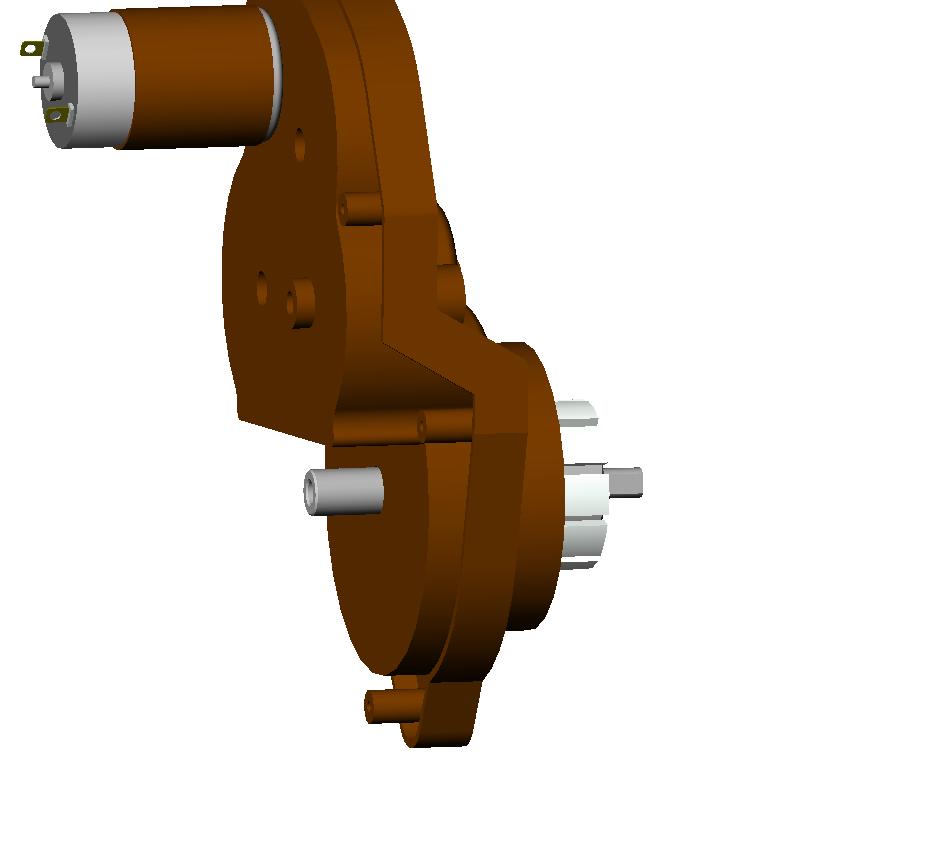

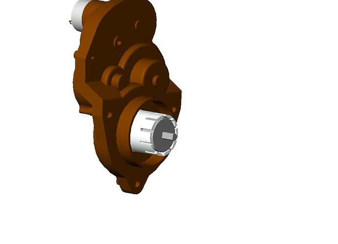

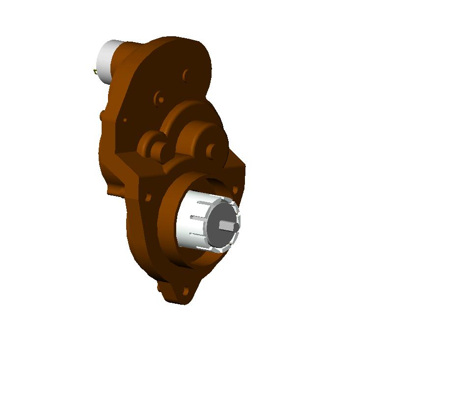

What we have done for several years now is make a round part that fits into the octagonal hole and feeds all the way through to the back hole. We use either steel or aluminum and screw the round part through the slots in the octagonal part. It makes for a very strong connection and allows you to put a potentiometer on the back side. A picture says 1,000 words so I will find a picture in the next hour or so. I will send another post with this picture.
This connection held up even when we broke our output shaft at Chicago two years ago (sorry 93 and 107).
-Paul
Here are the views I was talking about. I couldn’t find any pictures, but I have the solid model views. The real parts were made directly from the model so the views are accurate.
-Paul
Paul, today we did something very similar, and it works beautifully. Much better than trying to use the black coupler. One thing we found, is that by using 5mm bolts, which are larger in diameter than the slot is wide, and then drilling the slot out slightly to accept the bolt, makes for an extremely strong connection, even without the bolts tightened down.

Well, really whatever you want. Heres how it breaks down:
On the white output of the fisher-price, there is an octagonal hole formed by tabs. It appears to be round at first glance. So, by maching a round slug that fits in this octagonal hole closely, you have now effectively “Plugged the hole”. Between the slots of the FP output, you drive bolts through, into holes tapped on the Aluminum slug. So, the slug can then have whatever you want on it. Want to drive a 1/2" shaft with it? Machine and broach a 1/2" hole into the Al slug! All it is is really plugging the output hole with something that is easy to interface.
