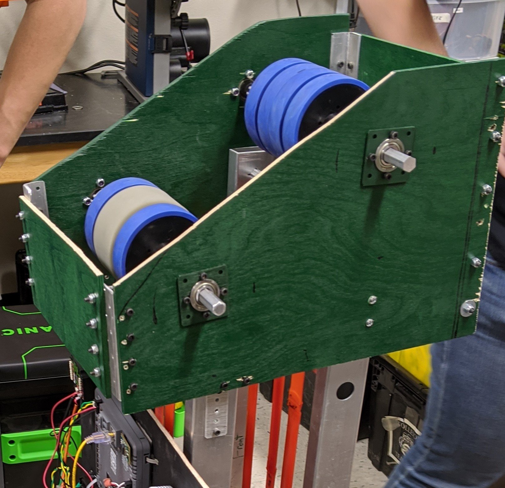

We are thinking of using plywood for our shooter sidewalls. We will be mounting 2 motors as well as bearings in the material. Has anyone had a problem doing this? We are thinking 1/4 to 1/2 inch plywood.
We do this all the time for prototypes and it will work. Our current shooter protoype is built from plywood. Be careful to reinforce the bearing holes by using a metal mounting plate. It doesn’t need to be very large, but will take the stress off the wood edges of the bearing hole and prevent them from wearing and loosening around the bearing over time (not usually a problem on prototypes, but very much one on a permanent mechanism.) Go with the heavier 1/2 ply too, since 1/4 ply is a bit too flexible for this kind of thing. I’d also suggest using metal motor mounts too, for much the same reasons as the bearings. Other than those cautions, it should work. Good luck!
For the motor and bearing mounts would 1/8 aluminum plate be sufficient?
Yeah, that should be enough to do the job. They’re only there to reinforce the wood, so no need for anything too hefty.

We did exactly this in 2020 for our shooter, nice thing with the face mount plate is if you aren’t driving the motor right on it you can cut it in half to get both sides of your shooter axle with one part.
It never saw an official field unfortunately but the shooter held up fine through practice and off-season demonstrations. We moved the shafts and have been using this as our test setup for launching cargo the past two weeks.
To minimize the over-constraint issue @philso highlighted you want to only put a bearing on one side of each plywood piece. I recommend clamping your two sidewalls together to drill holes through both pieces at once before assembly so the bearing holes line up closely. The standard hex bearings will tolerate a small amount of misalignment over a span - we have just under a foot between sidewalls and you could wiggle the bearing plate around a little before bolting it down without feeling the hex shaft bind as you spin it.

Wood (especially baltic birch) is a fantastic strong material. There is no reason that there is any more misalignment than any other material, that comes from the manufacturing techniques. We have built entire drive trains out of it with no issues with bearings in it at all.
People are predigest against it because it’s not cool. It actually has some big advantages to it when it comes to easily attaching things with simple methods.
What he said! If you use quality plywood you should not need any reinforcement plates. High ply count of a quality wood such as birch, maple, or other harder woods produce long lasting parts. You can even use a little wood glue on the bearings which will help keep it in place and will also strengthen the wood around the hole.

Should be fine, poplar is a good wood and that stuff is 7 ply over 1/2". Use a bit of wood glue in your bearing holes and reglue them if you ever see them spinning or vibrating in their holes. As long as they can’t move they cannot enlarge the hole.
