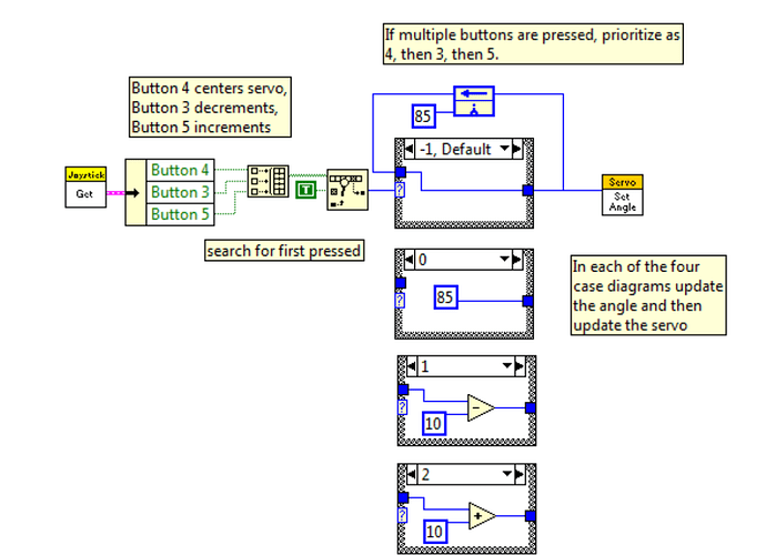

There are a number of good ways of doing this, but perhaps what you want is to identify an initial servo setting, say 90 degrees. Pressing a button adds a delta, say 10 degrees to the number and updates the servo. Perhaps another button will subtract 10. Alternatively, you could use buttons to simply set the number to a special number.
The code for this would look similar to the attached image. Note that I duplicated the case diagrams near it as printing would. They are actually stacked in the code as individual diagrams.

Okay, that makes sense, but in the picture, what are the blocks to the right of the button cluster? and the the right of the True? ANd the blue thing above the top most case structure?

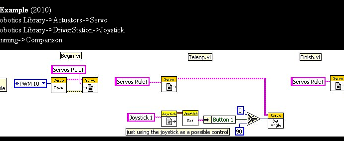

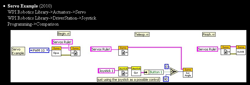

Attached is an example from team358.org
Sorry about that. I wasn’t sure how much LV you knew.
I attached the VI, and you can now show the help window and idle the mouse over each of the nodes to see what they are and what they do.
To answer you questions anyway:
The buttons I was interested in are indexed from the cluster and placed into an array. The array is searched for True to see which is pressed. The node with the magnifying glass is the search. The blue arrow box above the case is called a feedback node and is used to keep values from call to call. This “remembers” the value from last time. The case structure code updates it.

The appropriate example here is “Servo Camera.lvproj”, you might want to combine it with the example “Rectangular Target - 2013” and integrate both of them into your code.
