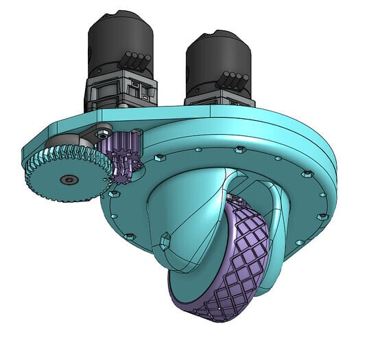

WOW! That’s really awesome I wouldn’t be able to do half of that. However, i do have one question. Have you found any negative sides to the prototype or anything that you think you can better improve? Also, do you think that moving forward you will be able to use it in a competition?

A sneaky steering mod would be to print a gear on the OD of your bearing flange and drive it from the servo!

The prototype was mostly built as a way to establish confidence in the design, and to identify things that could be developed further or improved. I discussed a few of the changes I made towards the bottom of my post, but your question will give me a bit of an opportunity to talk about a few more. :slight_smile:
  • A big question mark for me was the custom dual thrust bearing, I wanted to know if I needed a tolerance in the ball groove (basically gap between the balls and their groove, to compensate for the 3d-printed parts being too large or too small in real life). When I put it together the resistance was quite high in rotating the forks. After a bit of testing I realized this was due to the alignment of the “seam” on the 3d-print, basically where the material line of each layer starts and ends.
    Randomizing the seam placement in the slicer software, as well as adding a very fine gap solved this problem. Adding a little bit of lubricant helped here, too.
  • I made a stupid when I was doing the initial design, and didn’t leave clearance for the m3 bolt-heads holding the 1st drive gear onto the drive motor’s ultraplanetary gearbox (against the mating bevel gear).
    This was a pretty easy fix in CAD, I adjusted the profile underneath the spur gear section of the drive bevel gear (the middle dual gear piece that drives the wheel).
  • Lastly, I struggled quite a bit with cantilever on the steering pulley (the one attached to the servo). Basically, if a shaft is not supported in two or more places it will bend or deflect as tension is applied by a belt/chain. Even if a shaft is supported in two or more places, it will deflect. The shaft here is supported by the servo at one end, and the thru-bore encoder in the middle. In this case, that can cause the steering belt to skip teeth as it encounters resistance. I always think shafts are supported enough, they rarely are. This isn’t helped by the TPU belt I made needing quite a bit more tension than a regular belt.
    I solved this problem by increasing the solidity of the thru-bore encoder mounting, and adding a wall just behind it, all to prevent it from moving slightly and allowing for deflection in the pulley.

No, probably not. The design of this module hinges on the use of a lot of cheap or 3d printed parts, which don’t really scale to the abuses of an FRC competition event. I could see this being used on an FTC robot, however. The purpose of this module is mostly to explore making a really cheap swerve module, as well as writing software to control it.
This is a great idea, and might make addressing cantilever issues somewhat easier. My idea to switch to a gear was to integrate a female ring gear into the forks, reducing the module length by about 2" (at the cost of ~1/4" of vertical space). I like your idea quite a bit as well, it wouldn’t be as space effective, but would be quite a bit easier to design for and maintain.
The main reason I didn’t move to a geared design while working on this project was for ease of maintenance, that way the forks could be dropped without having to detach the encoder and servo. I wanted to try TPU belts, as well, and I’m happy with how that experiment went. If I pick this project up again in the future I’ll likely flirt with the idea of a geared steering variant. We’ll see. :smiley:
One thought on the bearing races; you can get better performance from a gothic arch type contact, rather than a simple round groove; these are used on full size four point of contact bearings.
Another improvement would be to add a clearance groove directly above and below the bearing balls; this keeps the bearings from having to touch the part that suffers the most from stair-stepping!
Another possible simplification for the OD gear steering would be to have a dedicated shaft for the feedback encoder.
These are awesome ideas. I’m hesitant to integrate a gothic arch style bearing groove, simply because this seems more prone to wear over time on a 3dp structure like this.
I do really like your idea for a clearance groove top and bottom, however. It’d allow for a good balance between contact surface area (for durability) and clearance (for lubricity).

So the V2 module I have built uses a 5:1 drive motor and 12:1 steering motors, but this is for a balancing robot use case, not a robot drivebase.
That said, the steering ratio feels about right, it’s snappy without sacrificing torque. The drive ratio lacks the torque and low speed controllability needed for a drivebase, so I’d go up to a 9:1.
V2 CAD can be found here, and here’s a screenshot of the module, for context:

Well if you haven’t gotten too far, definitely switch to the V2. I was never quite happy with the servo-based steering setup on V1, and CheapoSwerve V2 made a big improvement there. The encoder integration has improved a lot as well.
