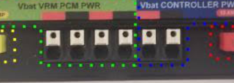

Today while rewiring our robot white part of a connector on pdp broke into pieces. Later on another one on pcm and one on vrm got stuck in pushed down position. I’ve been wiring robots for 3 years but never experienced something like this. Our workshop gets extremely cold during the night. I think cold+wear is to blame. I’ll be changing the connectors so I want to take special care of the news ones. Any tips for later use or ideas on what could be the cause?
The connectors I meant:

I now realized I wrote weidmüller connectors in the title by mistake. I was trying to refer to these connectors. Sorry for the confusion.
