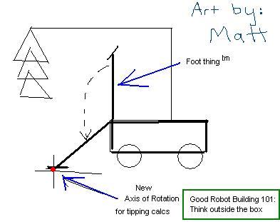

Alrighty…
I’ll go ahead and just do some math. (And engineering, it’s much better than math.)
We’re gonna take 3 tetra at 10 lbs each, 30 pounds. We’ll be crazy people and make an arm that’s 8 feet around a pivot (it telescopes out)
We’ll just use a piece of 3 x 3 by 1/8" box aluminum, 6061 with a yield around 36000 PSI.
That arm joint will weigh (3in²-2.75in²) * 96 in * .0975 lbs / in³ = 13.455 lbs
That’s 30 lbs * 96 inches = 2880 in-lbs for tetras
and
13.455 lbs * 48 inches = 645.9 in-lbs for the arm weight itself (not really negligible)
bending stress = M * y / I
M = moment
y = distance from center to extreme edge
I = moment of inertia (for a beam = h³*b/12 where b = base width and h = height in the direction of applied force)
(645.9+2880) * 1.5 / ((3^4-2.75^4)/12) = 2665.68 PSI
Factor of safety… about 13.5.
This proves that you can create something that will endure the stress using just simple materials.
The torque is a lot, but only when you start trying to twist around that axle of your pivot. Start thinking pulleys, counter weights, large moment arms on the back end…
I didn’t mean to go all formulae crazy… but… you dared me!
Matt
I didn’t see anyone worried about the strength of such an arm. The problem is stability of your robot. Try calculating the momments around the farthest edge of your robot. There is really no way you are not going to fall over. And how exactly does stowing a large number of tetras increase your tetras/min? The closest goals to the loading stations are very close. I suspect you will spend significantly more time loading and unloading then traveling, so multiple tetras does not help you that much.
OK Matt…your math is correct the one thing you arn’t thinking about is where the center of gravity of your robot is going to be at that point. your arm will definitely be able to support your tetras when your robot it lying on it’s side…:stuck_out_tongue:
assuming that the arm is extended 3 ft up and 4 ft out with a relative weight on it of 150 lbs ( perpendicular distance of 5 ft with 3 tetras on it)
even if the previous center of gravity was sitting on the ground the normal force of your robot would be unable to counteract the weight.
now this is assuming no counter actions, it is possible to make counter forces with springs, and shifting weight but i would still be cautious of doing so because of the amount of energy that would be stored. (for examples of this check out team 47’s bot from 2003)
I do not like your assumptions.
(edit: YIKES! That sounded a bit harsher than I wanted. I like Greg. I just didn’t like the particular assumptions he put on the problem. :slight_smile: )
i will admit that is a good solution, but that is assuming that you are completely motion less at the time but if you are moving you are going to have a dynamic moment that will also have to be counteracted especially when that arm outstretched starts to oscillate.
and all of your stresses will be on the hinge for that “foot thing”
it defiantly could work though
edit: matt don;t worry about it…this is one of those problems our professors tell us about where there isn’t 1 solution and it requires alot of thinking about all the possible solutions and variables involved
