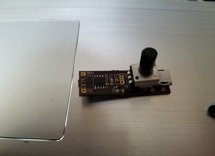

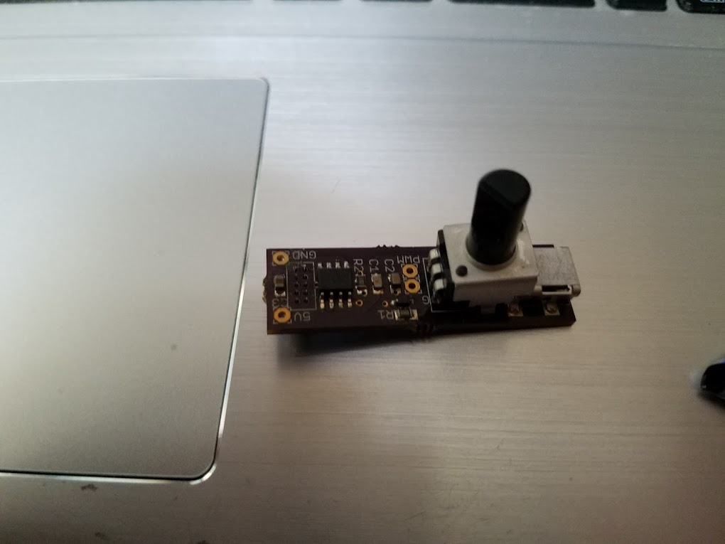

Lately I’ve been working on a cheaper alternative to the Pulsinator and Thrifty Throttle, because I am so cheap that I don’t want to spend $30 on testing mechanisms.
So I’ve created MVPWM-101, a $5 servo PWM generator that can be powered through USB port, plugged into a Talon SRX, or take any 5v input voltage.
Picture is attached.
I did screw up slightly on the potentiometer boundaries, which is why it sits partially on top of the USB port. MVPWM-102 will feature a micro-usb port to let users power it from laptops or external phone battery packs.
I’ll also be releasing a through-hole component version that should only be slightly more expensive, but let any team with a soldering iron make one.

Can you post source code and hardware BOM? Is it using an ATTiny85 or some other 8-bit MCU?
Just curious what you’re doing in code.
I can’t really tell from the picture but it looks like it could be a 555 timer meaning no code.
Oh, good call, it probably is a 555 timer.
Yup, no code! That’s why it’s so cheap to make. That also puts me at the mercy of the potentiometer and capacitor tolerances to determine the pulse length, but I accounted for those errors in the design.
