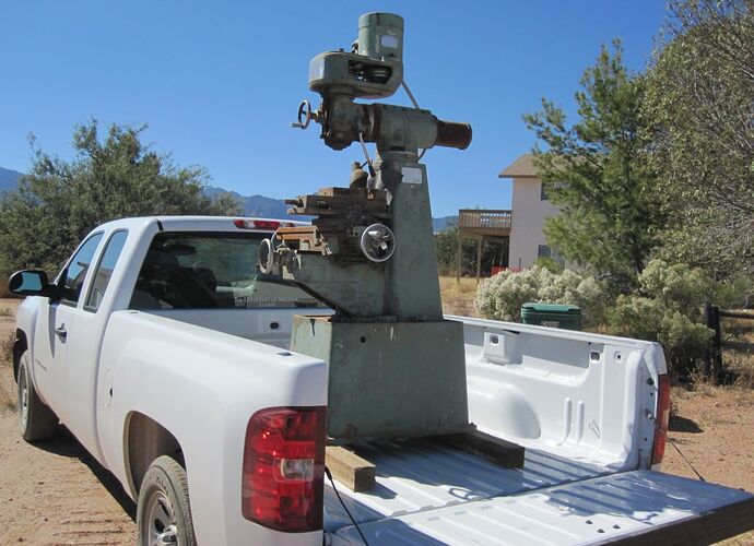

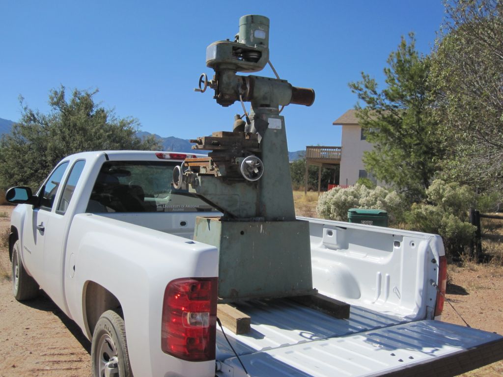

Look what I hauled home last week. I found it for $150 on craigslist and managed to be the first guy there with cash. It’s a Jet (made in Taiwan) 1980 vintage JVM-840 vertical mill. I’ve since torn it mostly all apart, and put it back together again. It has some wear, but it looks like it’ll be useable. I don’t really have much use for a mill around the home shop, but it’s been fun working on it, and I should be able to get it making chips for under $350 total. I got some tooling from a friend, and bought a Variable Frequency Drive on ebay for $30 to try. The mill has a one HP three phase motor, the power switch was fried, I think that’s why it was removed from service, as the previous owner said it needed a new motor. I checked out the motor itself, it all appears to be ok. The mill weighs about half a ton, so it’s not full Bridgeport size, and the table is only 7 x 30"

How’d you keep it from tipping over in the truck while driving?

I drove very slowly! We forgot to bring tie downs. The mill was bolted to a couple 4x4s about 40" long, so it wasn’t quite as precarious as it looks. Fortunately it was only about 2 miles away, and there’s not much traffic out here in the sticks.
I got the mill running, although it’s not quite perfect. I need to spend more money for a bigger VFD, as it will only run about 1200 or so RPM spindle speed with the little 1/2 hp drive connected to the 1 hp motor. At least now I know the motor does indeed work. And now I have a bunch of little aluminum chips all over the floor of my shop.
