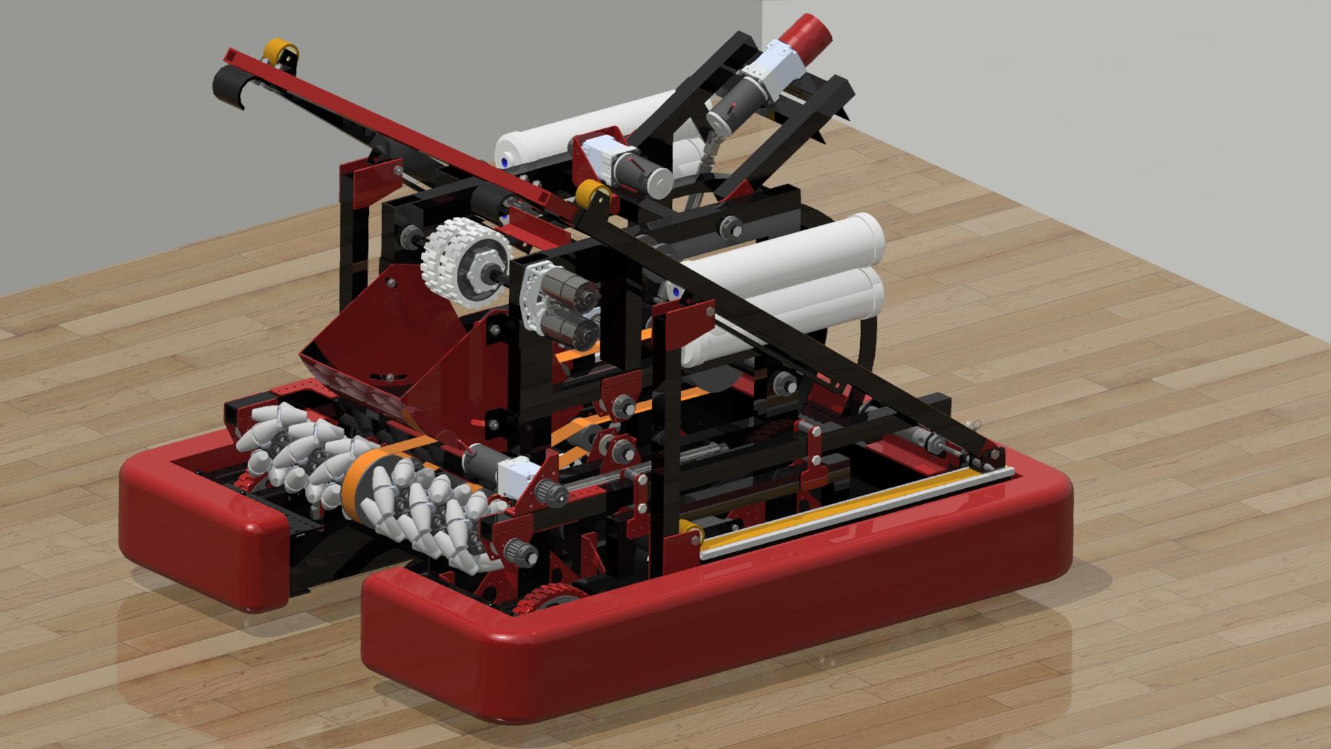

Hello! This is my take on the 2020 FRC game Infinite Recharge. I graduated from Kettering University in 2016 and am now a full time mechanical engineer who does 3D design almost every day. This is what I was able to come up with in my spare time, enjoy!
Weight: ~100 lbs (no electronics currently mounted to it)
Starting configuration: 27" x 32.3" x 27.75" (Long Kit-bot drive base), designed to fit under the control wheel.
Mechanisms:
  • Extendable ball intake reaches 8" out from the robot perimeter to collect power cells. Uses mechanums to bring balls to center opening where the conveyor system starts.
  • Conveyor system would be indexed using photoeyes or other sensors to keep ball spacing preventing the power cells from jamming or stacking on one another.
  • Ball launcher has two 4" wheels and is run by two 775 pros at a 3:1 reduction mounted using the vexpro female 1/2" hex adapter.
  • Control wheel spinner pops up using a 5" stroke cylinder when needed, and folds out of the way when not in use.
  • Climbing mechanism is a 2-stage telescoping arm that extends up to 71" (bottom of hook) and is then retracted using belts on a spool.
Unfortunately I do not know much about the electronics of a robot so this is just the mechanical design. (I’m sure some guru out there could get this thing running)
Hopefully this will give teams that are struggling some inspiration and ideas to pull from. I’m sure that what I have here can be improved upon, given that none of these mechanisms have been prototyped and they are just theory at the moment. However I did make my best effort to stay withing the design constraints of the game. Please let me know if you notice anything that doesn’t fall under the rules. :grin:
Have a great season everyone! I can post a more detailed doc going over each mechanism in greater detail with close up shots if you all would like.

Can you post a little more about your climb deploy? That’s a neat concept, and potentially solves one of our problems.
It uses 2 constant force springs on either side. 1x1x1/16 aluminum outer tube with a 3/4 square on the inside. I’m using a cylinder to hold back the slides at the bottom end of the tube, once released it allows the block to slide forward in the IGUS rail. The second hold back is a pin that goes through the outer and inner tubes that will be pulled by a tether somewhere along the travel of the slide. This is to prevent the arm from extending too soon and leaving the 15" frame limit.
The outer section has a slotted guide mounted to it that runs on a track to make the horizontal motion of the slide take the arm to a 90 degree angle.
Are you doing anything to prevent friction in the telescoping tubes?
If I was going to build this bot I would probably get some 1" wide teflon low friction tape from home Depot and layer it until I was happy with how the tubes fit together.

That design and these renders are really sick, but I can’t take my eyes off the mechanums going the wrong way lol
Oops haha
I’d love the full CAD model. What modeling software was it generated in?
This was done in Inventor 2020 Pro. I’m going to try to get the models uploaded somewhere tomorrow.
There’s some details here that I really think prototyping would have ruled out. The topspin shooter would create a very weird trajectory that would be hard to control from varying distances, and the conveyor system seems susceptible to jamming if it relies on sensors to get the necessary ball separation that a single-sided belt conveyor requires. Great render and great design, but if you’re on an FRC team don’t throw away your design to build this.
I agree with most of that. Especially with not throwing out your current design. As I said in the original post this is not proved out and it just a concept with no prototyping done to generate ideas.
However I think some spin is better than no spin.
