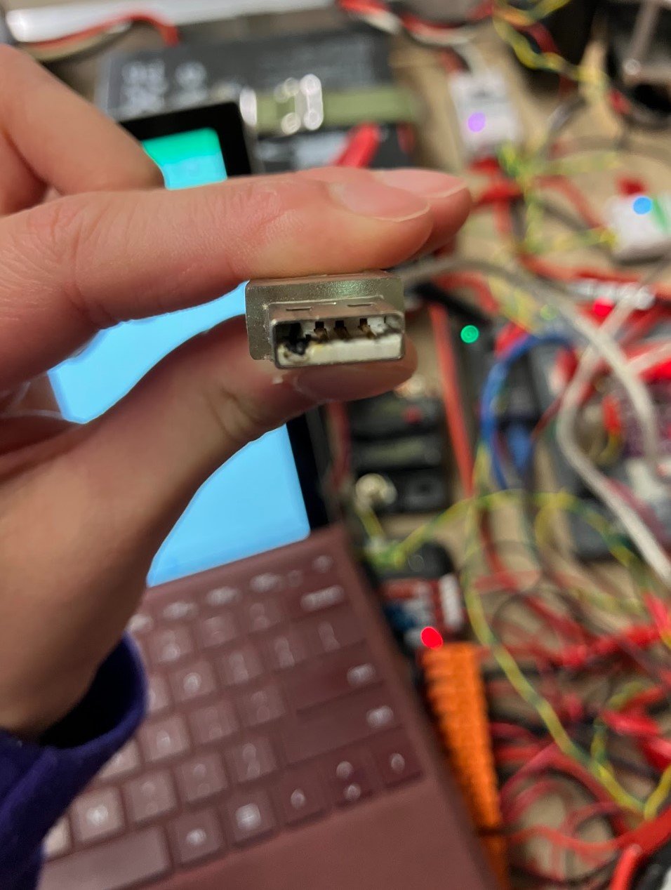

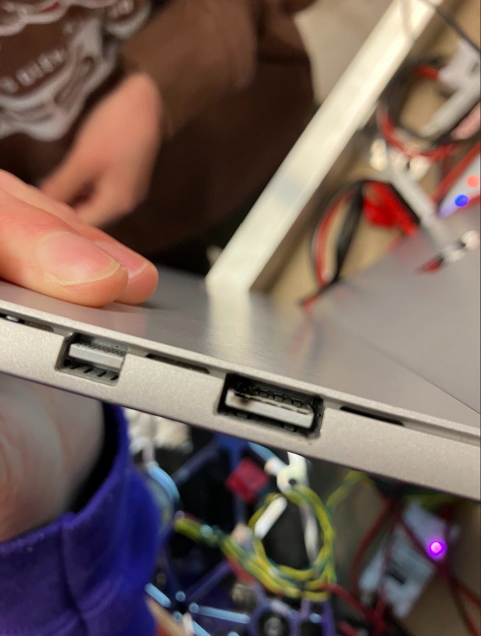

My usb port just started smoking while connected to the robot, is it still safe to use it?
We were updating CANcoders when that happened, we unplugged everything immediately and tried later, turns out my usb port still works. However is it still safe to plug anything into the port? Do I need a new laptop maybe?
Edit: these are photos of the damaged ports. It seems that the usb wire started burning first.

As far as is it safe to use it, you kind of already tried that out yourself it sounds like. If the port is functioning and you don’t see other external damage the only other place to check is internally on the motherboard. I DONT recommend trying that yourself. If it’s working it’s probably okay. If you are worried have it checked out by a professional. They can likely replace the USB bus (it’s usually a module of several USB ports, HDMI, headphones etc on a laptop) just as a precaution.

My laptop was plugged into the roboRio, and the laptop end burned
This is definitely a RoboRIO issue or laptop issue then. Nothing else in the setup should affect this. You can go contact NI support via their forum to get this replaced. You should try it on another laptop to see if it sticks smokes, but that might risky given what you’re said so far. Maybe just plug it into a cheap wall wart 5v supply and see if the supply suffers the same fate.

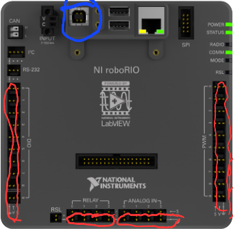

Definitely let’s start by checking the wiring on the RoboRio with it powered off, pictures definitely help. The first places to look are for where the power and ground rails are in each area. (Marked in red, bad drawing I’m sorry, but the v and gnd symbol lines)

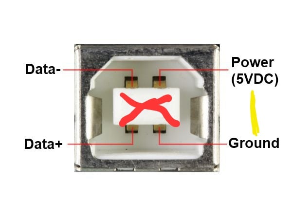

Then look for any damage in the USB connector itself (blue). There’s 4 pins there seperated by some plastic, if that is messed up or missing entirely (Ive seen that before) those pins can bend, short out and cause all sorts of not good things
usb2-Bpinout-600
Imagine that little seperator goes missing and the 5v and gnd make contact.

Most, if not all, laptops have USB over current protection and will shut down the affected port to prevent something like this from happening. The computer sources power to the downstream device.
