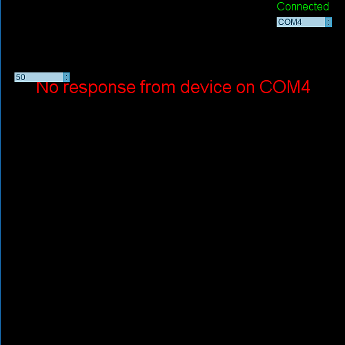

Last year we successfully used our Nav-X MXP during competition. But after upgrading the Firmware to the newer version(3.0.314) we were unable to read any sensor values.
After booting all lights turn on for 1s, then only the 3.3v led turns on with the CAL led slowly flashing. This happens with the sensor connected directly to the roborio and trough usb to a pc.
Im also unable to get any readings from the NavXUI. When connected to the roborio i get the following error message on the Test window vi:
FRIC_navX_Internal_SPI_ProcessingLoop.vi:620001<ERR>
CRC mismatch 1 =/= 255.

I have attached a print from the test window. We have already tried to reflash the new Firmware and go back to the older firmware, but the error remains the same.
Any input on this would be greatly appreciated!
It looks like you are getting CRC errors. I think the CRC errors are a red herring.
The clue here is that per your description the two green LEDs (S1 and S2) are not solid on (after the first second of startup).
The secondary clue is that I believe you are getting no data at all - a permanent failure. The CRC timing issue is a sporadic failure, not a permanent failure.
With a permanent failure (in which case the S1/S2 green leds are not both lit during normal operation), there will be no messages sent by the navX-MXP because it can’t talk to the onboard MPU-9250 at all. And that means there’s likely no response from the navX at all when an SPI request occurs. Which of course will be interpreted as a CRC error.
What you need to do is run the Factory Test Procedure (http://www.pdocs.kauailabs.com/navx-mxp/support/factory-test-procedure/. In particular, you need to confirm that the two green S1/S2 leds are working properly.

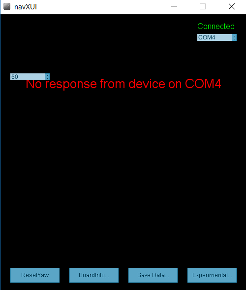

The other validation to perform is whether the navXUI (connected via USB to a PC) works. If the two green S1/S2 leds don’t work, navXUI won’t work either. At that point, we’ll have confirmation of the problem.
It’s possible something went south during the firmware update and you need to reattempt it. This can occur if the hex file is corrupt, or if the transmission of the complete hex file is interrupted during the firmwmare update process.
If after reflashing the firmware again the problem still persists, you should contact support@kauailabs.com for a replacement.

Thanks! We have tried to flash the new firmware again from other computers but it didn`t showed any effect. The NavXUI appears to detect the board, but shows the attached message. From what i read on their website it looks like the board might be stuck on the omnimount setup.

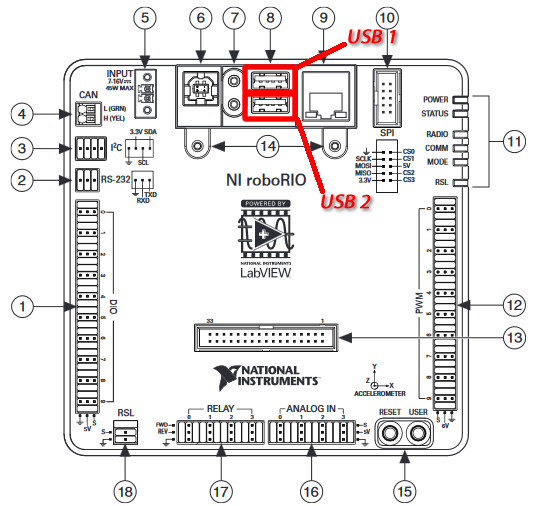

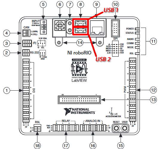

OK Here is the run down on the USB. For the RoboRio you have to designate what port you are talking to. Here are some pictures that should help with the setup. If this does not help please let us know.

So we made sure that we have USB 2 selected in Robot main because we have it plugged into port 2, but we still get the same error. We have a LifeCam HD-3000 plugged into the first USB port, so I don’t know if that is what is screwing us up or not.
I attached a picture of what we get from the Roborio dashboard. I am not clear on how to bind the USB port–could you elaborate?
Hi Eric,
I did some testing and was able to get the navX-Micro USB-connected along with the Microsoft LifeCAM HD 3000.
However, if “USB 2” is selected, communication to the navX-Micro USB doesn’t work.
Here’s what I tested that does work:
navX-Micro USB connected to RoboRIO Rectangular USB Port 1, LifeCam in USB Port 2. LabVIEW navX USB selection: USB 1. Works.
navX-Micro USB connected to RoboRIO Rectangular USB Port 2, LifeCam in USB Port 1. LabVIEW navX USB selection: USB 1. Works.
So I believe the solution is to simply specify USB 1 in the navX-AE LabVIEW Library; the WPI Libraries are apparently intelligently selecting the second USB port if it can’t find a USB serial device in USB port 1.
In talking w/Thad House who works on the WPI Serial Port code, USB 2 is only valid for use if another USB Serial device is connected to USB 1. Since the Microsoft LifeCAM HD 3000 is not a USB serial device (based upon what is displayed in the RoboRIO Web Dashboard) this means USB 2 should not be used. I’ll write up some clarification on this on the navX-MXP/navX-Micro websites.

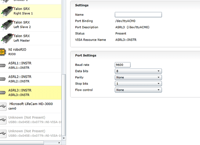

So doing some more digging, it appears that the USB camera creates 2 unknown devices on the Roborio in addition to displaying the LifeCam connection. We believe that it is these two unknown connections that screw up how the Nav-X program tries to find the device.
When we do NOT have the camera plugged in, the 2 unknown errors and the camera link goes away, and we can get readings off of the Nav-X board.
I attached a picture of what we see on the roboRio connections.
Does anyone have any ideas on if we can permanently fix the port that the Nav-X board is looking for as opposed to searching the ports or if there is a way to get rid of the 2 unknowns created by the camera? Thanks again!
