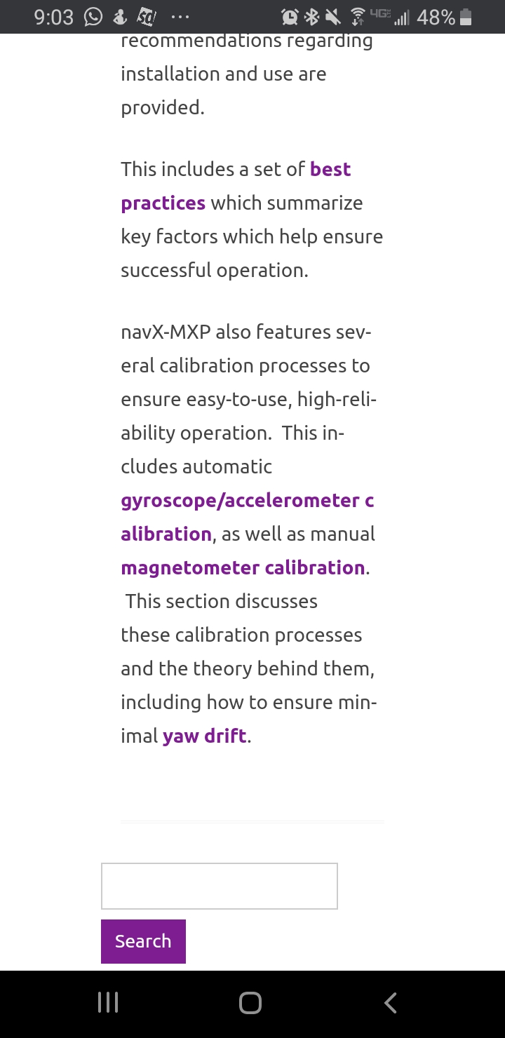

Perform calibration with your motors off?
(See the guidance page)
