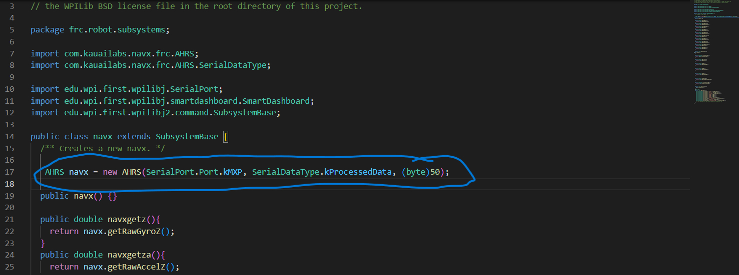

Here is our code:
I strongly suspect that the issue is the way you’re initializing the AHRS object; specifically, you aren’t passing the SPI port into the AHRS (NavX) constructor like @gdefender suggested.
In your navx.java file, on line 14, you initialize the NavX as follows
AHRS navx = new AHRS();
According to the example code provided by Kauai Labs, it needs to be
AHRS navx = new AHRS(SerialPort.Port.kMXP, SerialDataType.kProcessedData, (byte)50);
Give this a try and let us know if it solves your problem.
The first line will initialize the navx with the default interface (MXP SPI). I don’t recommend changing it unless you have a good reason (something else using the spi port or navx not on the MXP).
My bad. The provided sample code needs to be updated then.
We wrote the navx with you said that way but it’s not worked too

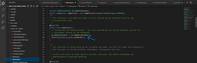

And we have only calibrate method in robotinit part in robot.java

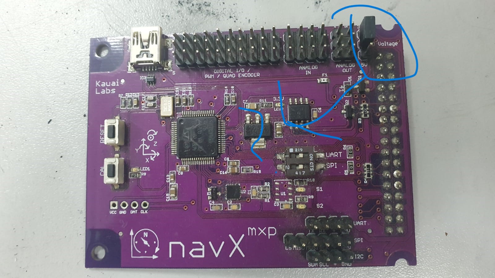

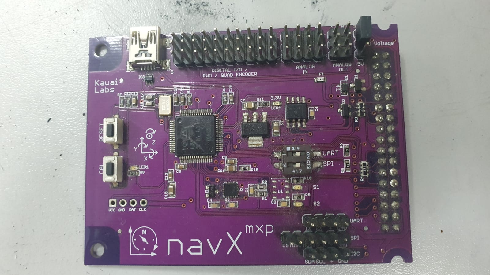

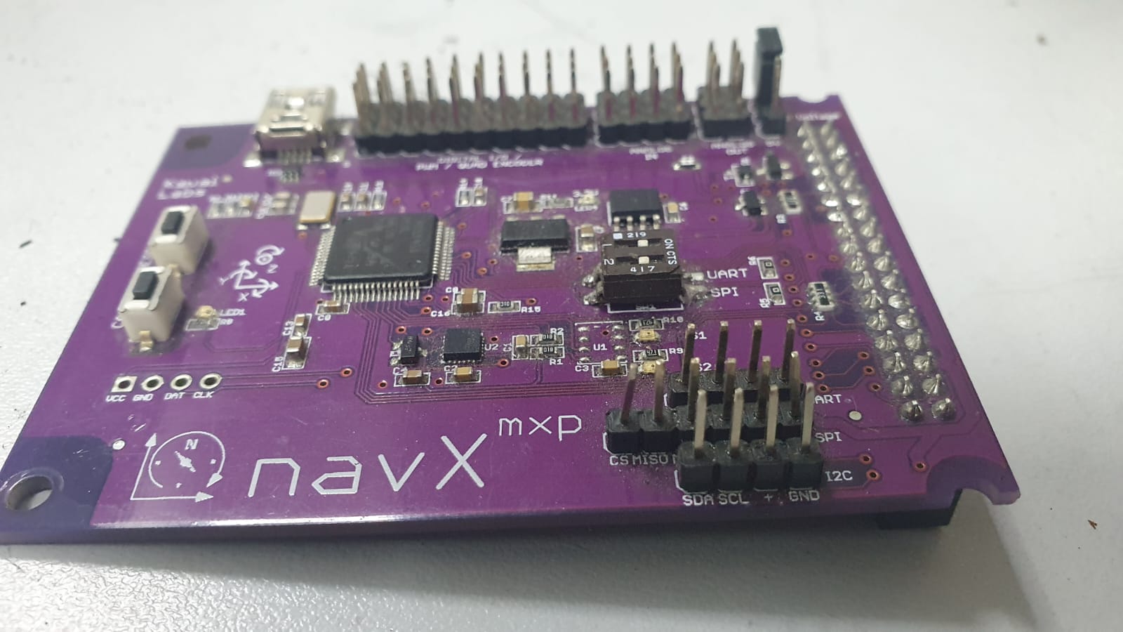

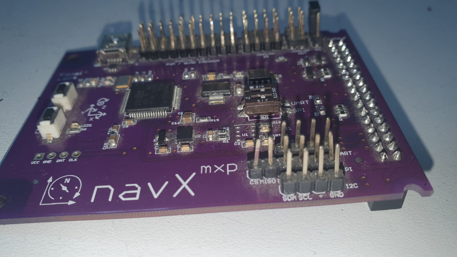

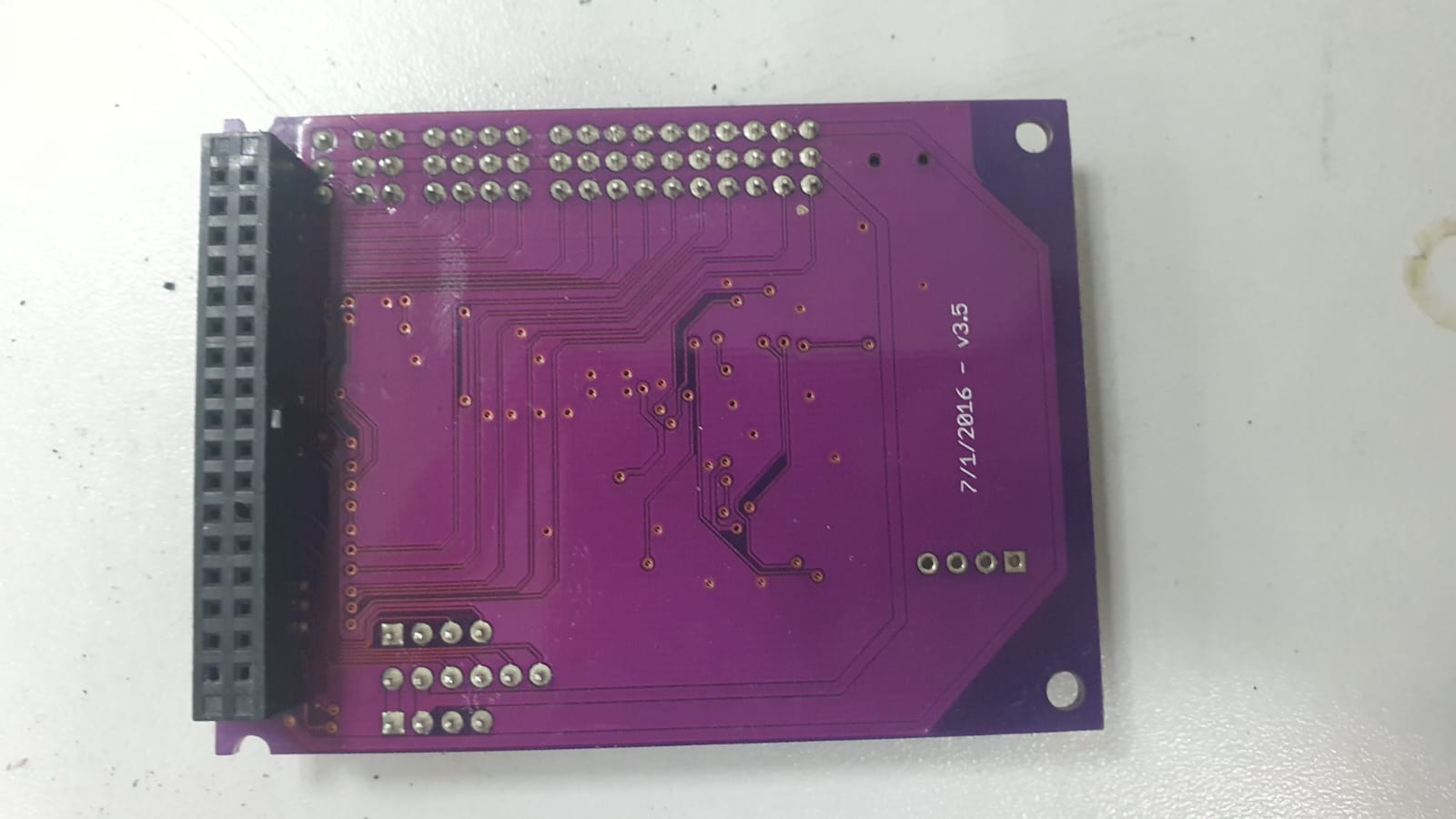

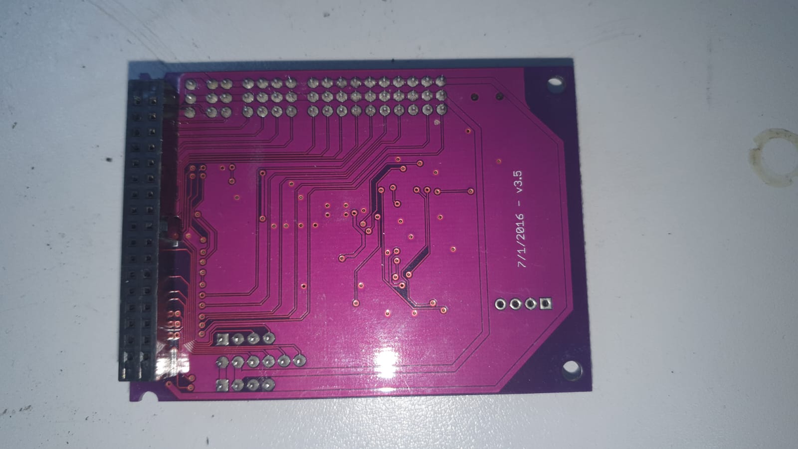

Heating is a sign of a short. Is the board scratched or are the pins on top bent?
We couldn’t found any scratch or bent on pins we took some image:
Flashed photo from top
Normal photo from top
Another photo from top
Photo from back
Flashed from back

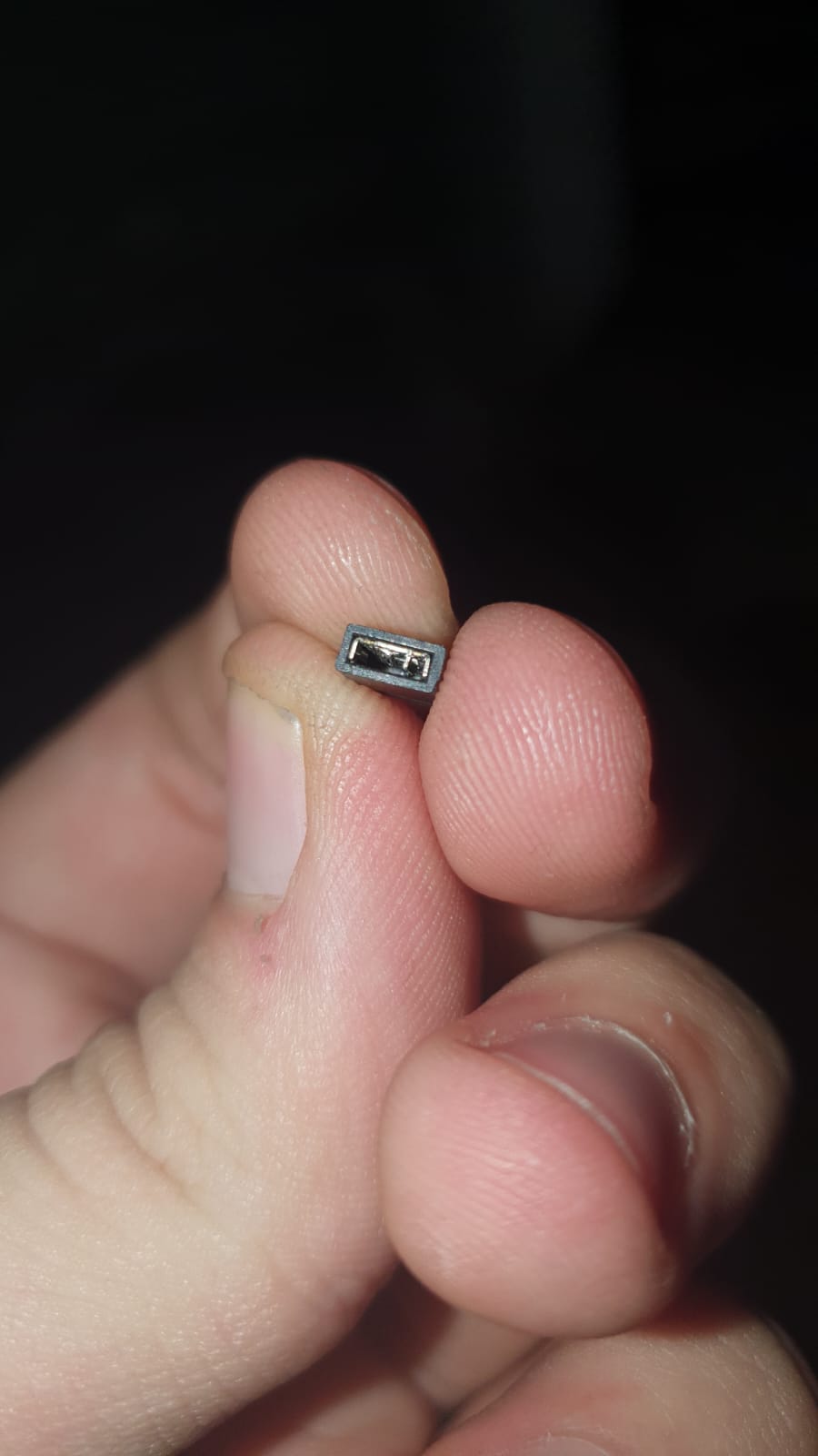

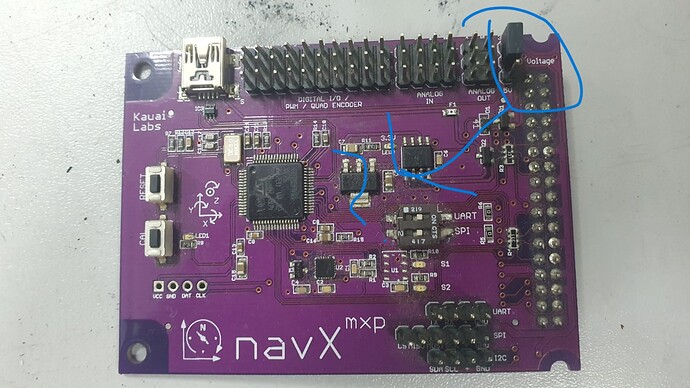

We have this pin that connected to 3.3V should we change to 5V or remove it completely and I think we putted 5V and it didnt worked too
Inside of this pin
I don’t see any obvious physical damage, so it’s probably dead.
The jumper is for devices you connect to the NavX, so it shouldn’t matter.
