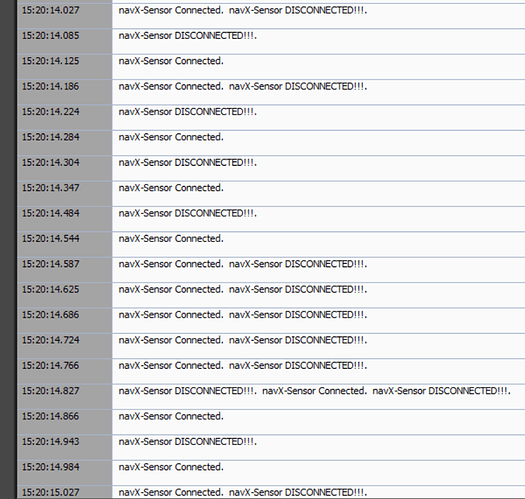

We have been using navx through rio MXP for a couple seasons now and have run into this new issue this season where it would spam disconnecting / reconnecting / reset detected. This happens randomly (every 10 ish seconds) only when we are enabled. I am confident it is not a power issue because although the bot is enabled, we aren’t really driving it at the moment, and it happens when the bot is enabled but completely idle as well. I see that there are similar issues already on CD, but are all related to browning out which we aren’t having. There are also no wires run over the navx so I dont think EMI is an issue.

When initializing the navX to use SPI (protocol we used last year with no issue), it would spam disconnecting / reconnecting / reset detected randomly every 10 ish seconds.
When initializing the navX to use I2C, console messages go in the order of:
  • navx disconnected
  • navx reconnected
  • *and then robot comms die (super weird but this happens consistently)
This is mostly just a drivebase at the moment and the rio just has power, ethernet (via rev RPM), an empty canbus loop that is terminated to the REV PDH, USB to canivore with a non empty can loop, and of course the navx2 connected via MXP port on rio2 - properly screwed in.

TROUBLESHOOTING UPDATE
When replacing with a navx1 through the same(and only) rio MXP and initializing via SPI, it works just fine…but we want to use navx2 for the improved yaw values.
Also, a blank code file with just the navx init doesnt change our outcome from the original post.
Check for metal shavings in between the pins of the navx.
combinations of 2 different rio2s, 2 navx2s, 1 navx1 - all visually inspected all have the same intermittent disconnect reconnect issue.
With an isolated system of just a power supply, radio, navx not on robot- same issue happens
Navx1 works fine on both rio2s.

For everyone, here is the collection of all the combinations we have tried. Combining our 3 rio 2s and 4 navXs. And all parts were visually inspected, in fact one of the rios and navx2s are brand new.
Using NavxUI, I verified that all the navxs are writing good data. And when the navx isnt in its disconnect, reconnect cycle, we do see good data on smart dashboard from it.
they fail on all the ports when using 2023 image and navx2, here is a spreadsheet of all our data.
Can you verify the actual firmware version you’re running in the NavX2? I’m pretty sure we’re not on the latest firmware though. But if you’re on the latest, then I don’t suspect that’s the issue. From your data it points towards a difference either in the 2023 Rio2 image, or the new 2023 Kauai library.

Updated the spreadsheet with navx firmware versions. I only updated 1 navx2 to the latest firmware so I would have a range of versions to test with. All versions are supposed to work right?

Our solution was to keep the navx in the mxp but just communicate via usb serial protocol as it is just as fast. Kind of a workaround, but it works.
Last night we had a situation where our 2022 robot (with a RoboRIO 1) which had been upgraded to 2023 WPILib, etc., had the same error of the NavX2 suddenly disconnecting and reconnecting repeatedly.
So I think that points to a 2023 image problem, not a RoboRIO 2 problem.
We’re trying the serial port option (using one of the USB ports on the RIO).
