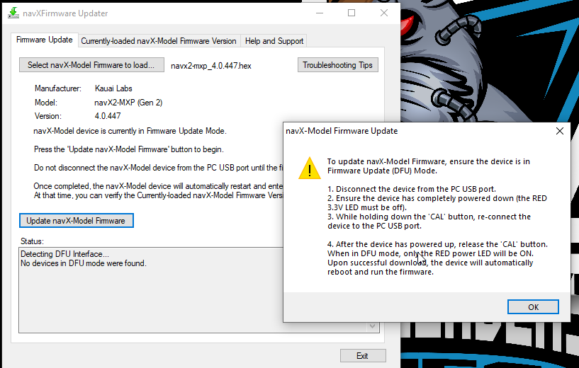

thanks @Technologyman00 I am unable to update the fireware and here is the error I get. I am following the instructions properly.
Fixed the issue
It would be helpful to others searching the forums in the future if you posted what fixed it.
Extremely likely they didn’t put it in DFU mode
I had to put in DFU mode:
  1. Open Device Manager
  2. Find the device under the Universal Serial Bus heading
  3. Right click the “STM32 BOOTLOADER” device and choose “Update Driver”
  4. Use the “Browse my computer for drivers Let me pick from a list of available drivers on my computer” option
  5. When list comes up pick the “STM Device in DFU Mode”
  6. Go back and start the firmware update process over again
