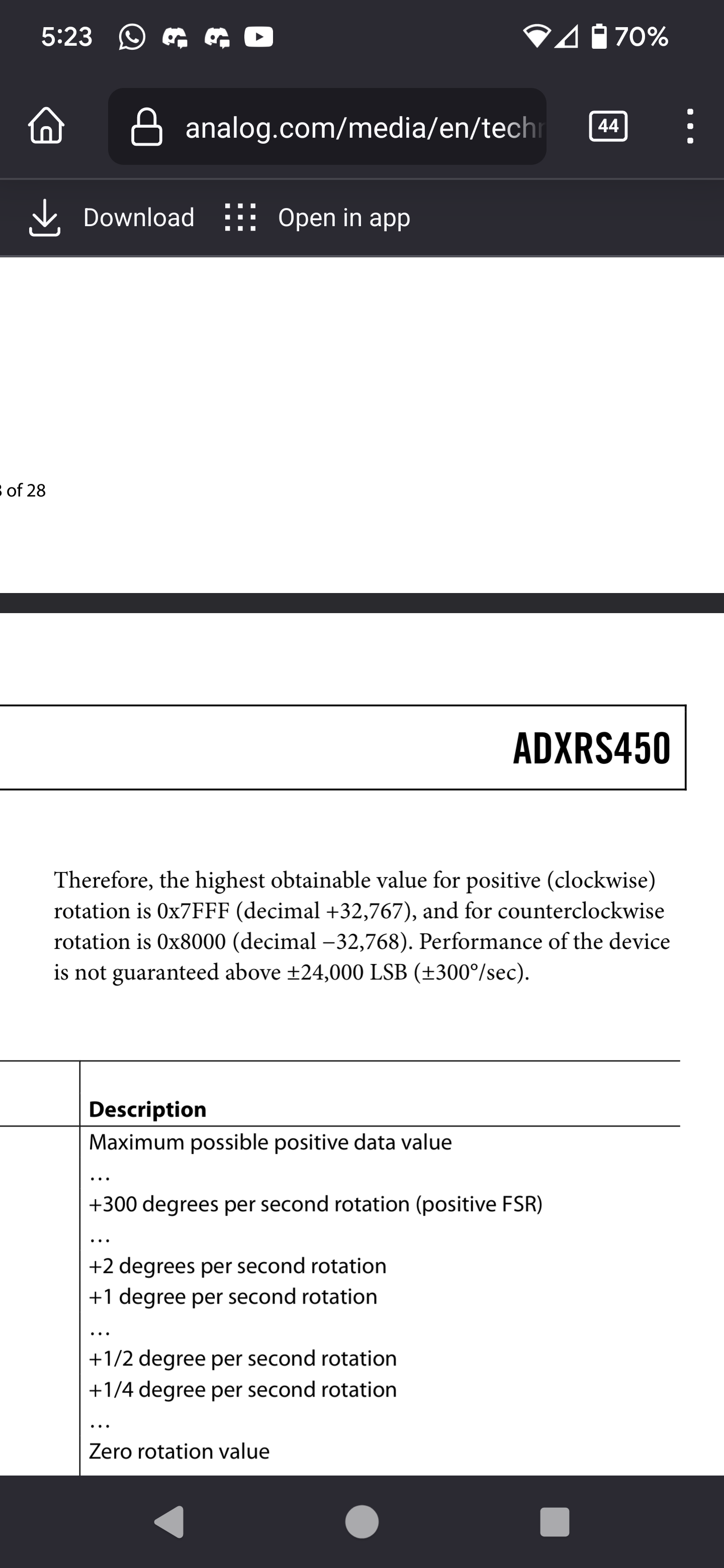

Thanks for the very quick response, much appreciated. I just wanted to verify whether the ADXRS450 reports angles for rate and angle as clockwise or counter-clockwise. I suspect I know the answer but would like to verify as we start to code subsystems for both the NAVX2 and ADXRS450.
From the spec sheet I’m guessing clockwise is positive
