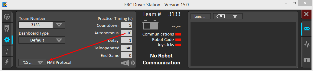

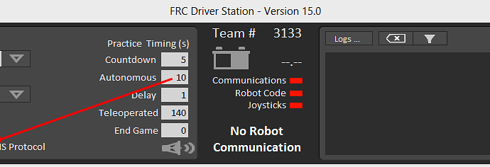

Could you explain exactly what I need to do to run last year’s robot from the new driver station software (I’m not sure what the arrow in your image means)? We tried today and didn’t know what we had to change…then we were afraid to update the drivers’ station laptop for fear of losing the ability to drive the '14 bot.
The switch freak is pointing to lets the 2015 DS interface with the 2014 FMS. My understanding is the 2015 will not talk to the 2014 robots. Apparently the switch that allowed it to run 2014 comms in the Beta testing was dropped. My programmer tells me the 2014 DS will run on the 2015 system. I have not actually seen how he tested this. Maybe somebody more versed in Lab View will comment. (The DS is a labview program regardless of what language your robot is programed in.)
The 2014 and 2015 DS have different EXE names. I do not have both installed on my laptop, and I don’t control the installers, so I can’t say much about what that will do, but the programs can coexist with no problem. Each has its own set of DLLs and a reference to a LV runtime.
The 2015 DS can actually control 4 slot cRIOs that have been updated to 2015 image. Those cRIOs will then speak the 2015 protocol.
The 2015 DS and roboRIO can also speak the old protocol, but this was turned off during the beta in order to avoid misconfiguration.
So in order to better answer your question, do you intend to update last year’s robot to this years development tools and image? Is it a 4-slot?
If not, I’d lean towards zipping the old c:\Program Files\FRC Driver Station folder, then installing the new one, then unzipping the old one into a folder something like 2014 FRC Driver Station.
