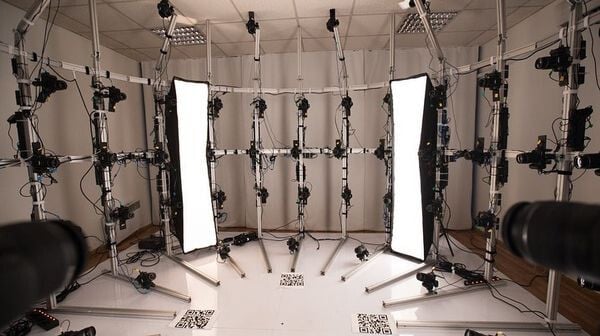

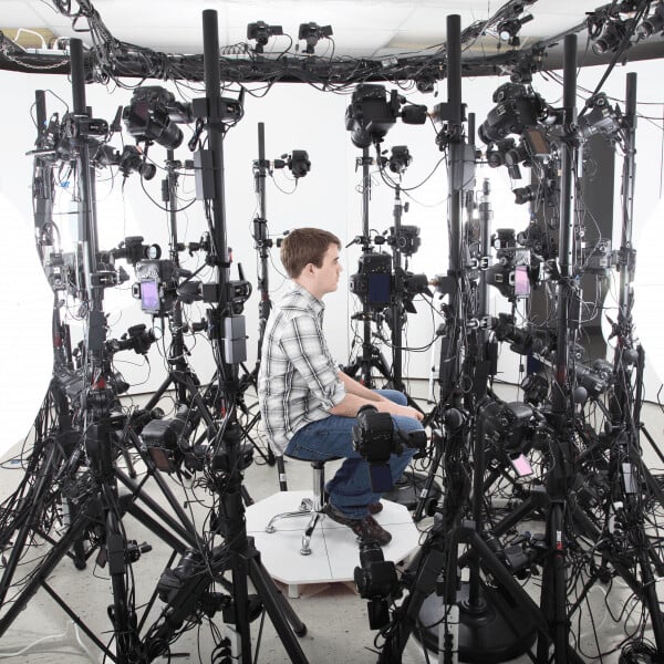

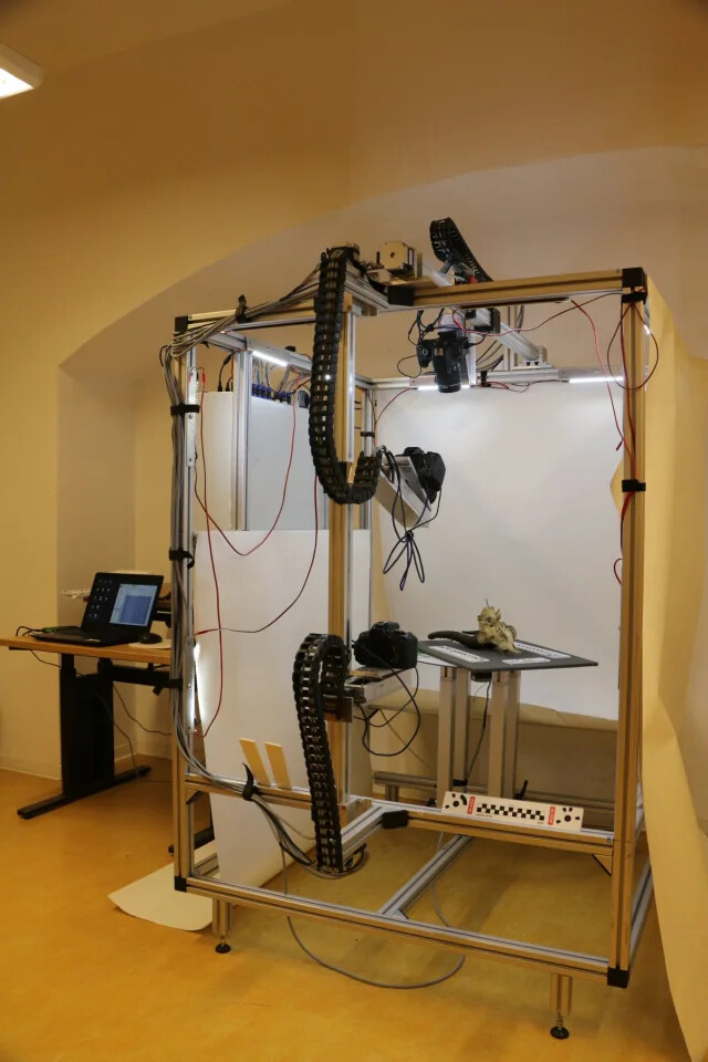

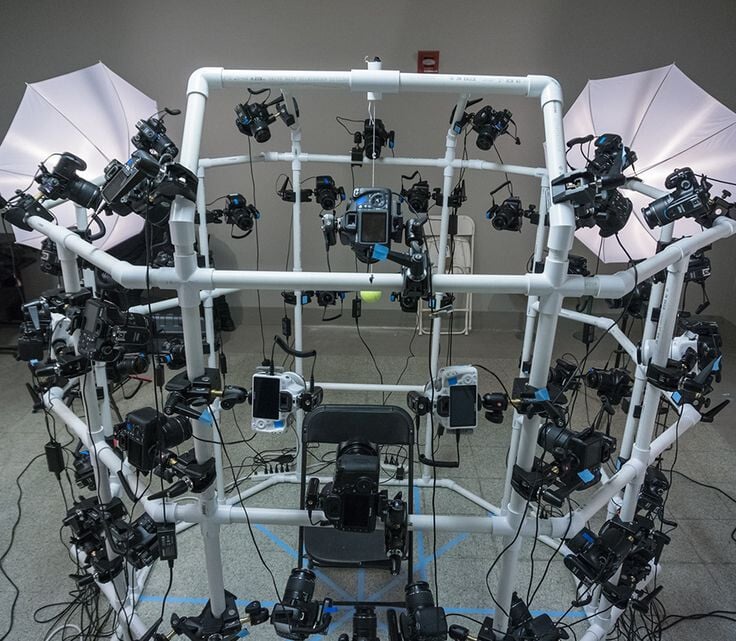

You may want to look into 3D scanners that use DSLR cameras. They are normally called DSLR photogrammetry rigs. Add a conveyor belt and you will have a nice semi-automated system.
There are rigs that require much fewer cameras but tend to have more moving parts. Just depends on how many angles you are doing and how many pictures you want to take per product. Also, I would look into doing focus stacking to get super crisp product photos.
With all that being said you may want to look into one of these.
