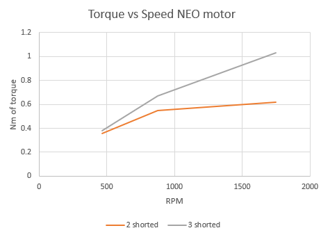

I did a lot of testing with a NEO a while back looking at all four quadrants of operation and braking mode. Lots of gleefully over the top and janky testing! Neo braking mode information - #2 by Weldingrod1
When the motor is commanded to be at zero speed, brake mode is 100% shorted wires as discussed above. In fact, its better than two shorted wires! You must have all three shorted to simulate what a spark max is doing! I tested this too…
