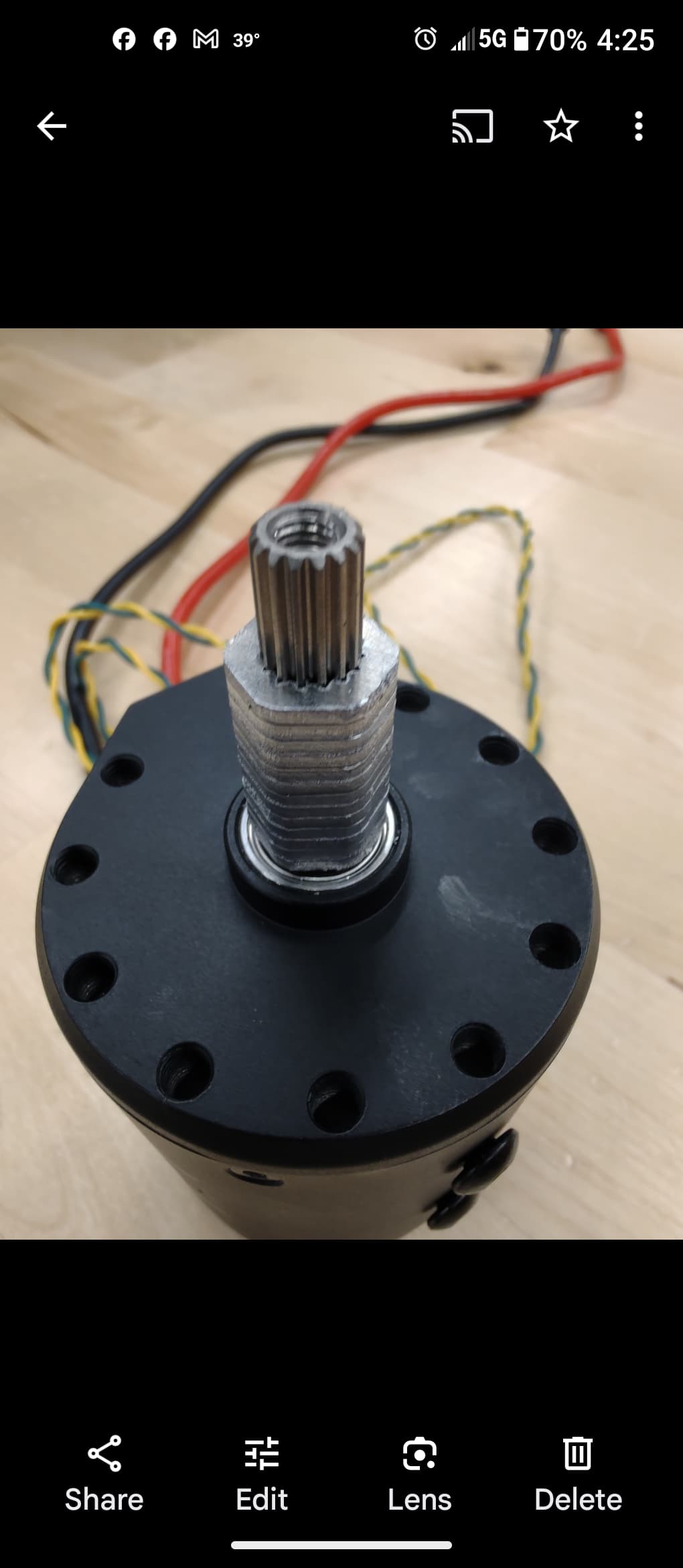

We downloaded the CAD file for that part. We have access to a metal cutting laser and cut many “washers” with the same profile. The spline on the inside and hex on the outside. Then stacked them up. Been working pretty well for us.

We actually use it to drive our scorer 1:1 with a Kraken with .25" compression. It is a low torque, high rpm application. Never had any slippage or anything. We actually designed a slightly different adaptor with a slot to get compression with a shaft collar, but we never really needed it.
We’ve had great luck just printing spline xs bores into pulleys. They hold really well so far.
Definitely caution against doing this on anything that moves fast/has agressive acceleration (honestly just in general). Tiny bit of heat and the PLA will fail, that bore is gonna become a circle.

If you’re using an outer 3d print, you can print for other profiles besides a hex. In the past I’ve used gears with great success. You could get an in stock kraken gear and imbed that instead.
We use them on our shooter motors, which spin fast and accelerate and decelerate at extremely high rates, multiple times a match. Also used on our intake motor which is cycled the same way. Both PLA and nylon prints, never had an issue.
That’s fascinating, the conventional wisdom to not print splines developed around falconspline, which definitely have a subtly shallower profile.
That’s all on a bambuLabs with a 0.4 nozzle?
Layer height, # of walls, infill?
Edit: stator phase current limits?
All on bambu printers. 0.4mm nozzle, 4 walls, 35% infill. So far most of our tests on 3D prints find the failures are in the infill before the walls fail (when designed correctly and loaded appropriately).
Definitely goes against the grain in the conventional wisdom, and I think it’s only something I’d trust to work on long pulleys. Our printed spline bore fits are intentionally tight for maximum surface contact.
20mm+ / full length of motor shaft?
With a 9mm wide belt or a 15mm?
Our intake motor pulley is the 15mm wide WCP kraken pulley printed out, our shooter pulleys are 9mm wide.
