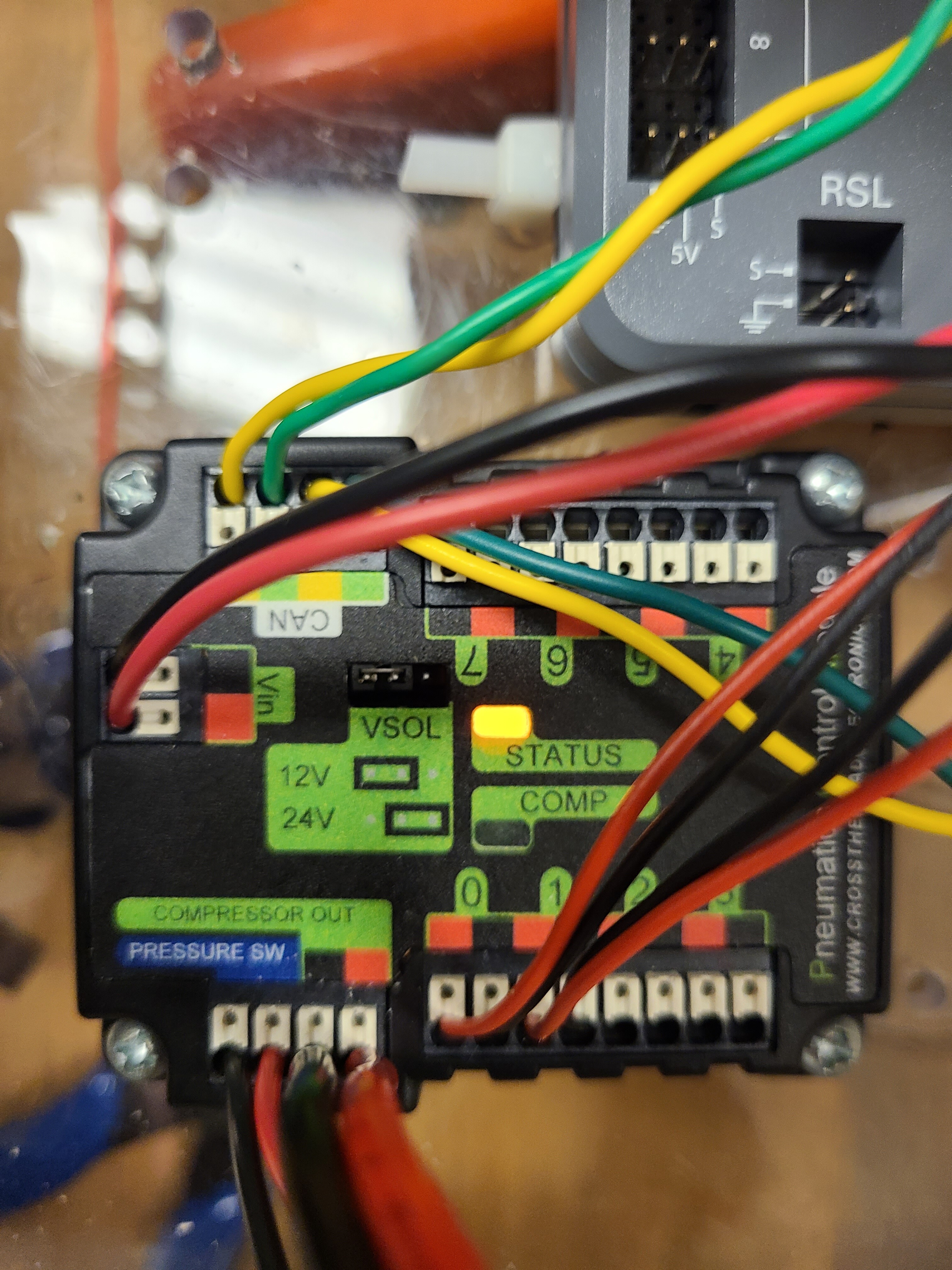

Need some more help, this time with the pcm
We have a problem with the connection fr the pcm to the compressor. The pcm does not read. We have plugged in everything and there is a true loop shown in the console, but no indication light. The compressor doesn’t turn on when the bot does.
We have tested everything seperately. The everything is powered except the pneumatics. They work with a thrifty throttle though.
We have been using the user’s guide for pcm but can’t figure it out. Does anyone have an idea of what the problem is. Thanks in advance

Is there a floating ground on channel 1? It sort of looks that way. I am not sure that would cause this though.
The compressor doesnt turn on when the robot is enabled. We are trying to use a multimeter right now
There is not a floating ground
If you run a self-test on the PCM in the phoenix tuner does it say that the compressor is enabled? If it does and the compressor still isn’t turning on chances are your PCM is broken. If it’s not enabled, then you should check the pressure switch wiring to make sure it’s triggering properly

What is the STATUS LED doing? Blinking? Colors?

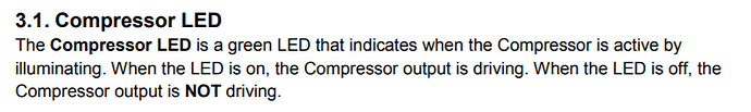

Is the COMP LED turning green? If so, check the compressor outputs with a multimeter – should see 12V. If not, try shorting the two “PRESSURE SW” with a jumper temporarily. This eliminates the pressure switch and wiring as suspects. BE SURE TO LEAVE THE PRESSURE RELIEF VALVE OPEN when doing this!
Be sure the PCM shows up in the Phoenix Tuner utility. Note this link has troubleshooting steps.
(More detailed info on the LED states is here – section 4.1 is about troubleshooting this specific issue.)
The status light is green. There is no light for the comp

Is it just that part of the CAN bus wire isn’t twisted or is the entire CAN bus wire that goes off to the right are not in a twisted pair configuration???
