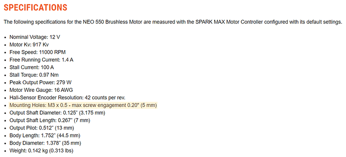

Just a quick finding from tests with NEO 550’s: If you use 2 cm screws, they will rub inside and burn. Also, when they smoke, they smell like cigarette smoke instead of fish lol.

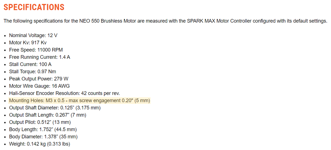

I mean, the length of screw depends on what the motor is being mounted to.
“Do the math, save the world [and the motors]”
