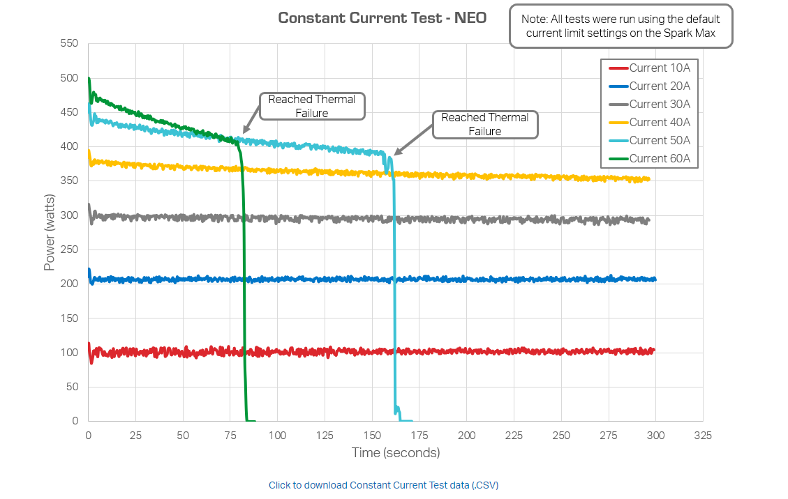

Current Limiting is a function we have built into our motor controllers, so whatever current limit you set, it will adjust the power output to never go above that setpoint. (yes this does effectively de-rates the motor performance at stall)
You can set this limit in the REV Hardware Client Navigating the Client - SPARK MAX - REV Hardware Client
If you want to read the current during the match you can use our API’s to do so Troubleshooting - SPARK MAX
Yes you would be stalling it, however you can adjust the stall current so that it is low enough that it does not harm the motor. Unfortunately, I program in labview so I do not know the pertinent commands.
Specifically, keep it a reasonable margin under 40A, and life is good

The current limit allows your mechanism to hit the hard stop without destroying itself - or the hard stop. You could measure velocity - but again, by the time you’ve decelerated you’ve already slammed into your hard stop and destroyed it if you’re applying too much power.
Limiting both max velocity and motor output to prevent mechanical damage would be an acceptable solution. Motion control would be ideal. Limiting the current so it simply can’t hurt itself is easiest.
You may find that based on the momentum or gearing involved it’s impossible to effectively limit current enough to prevent damage, in which case motion control is really your only solution.
