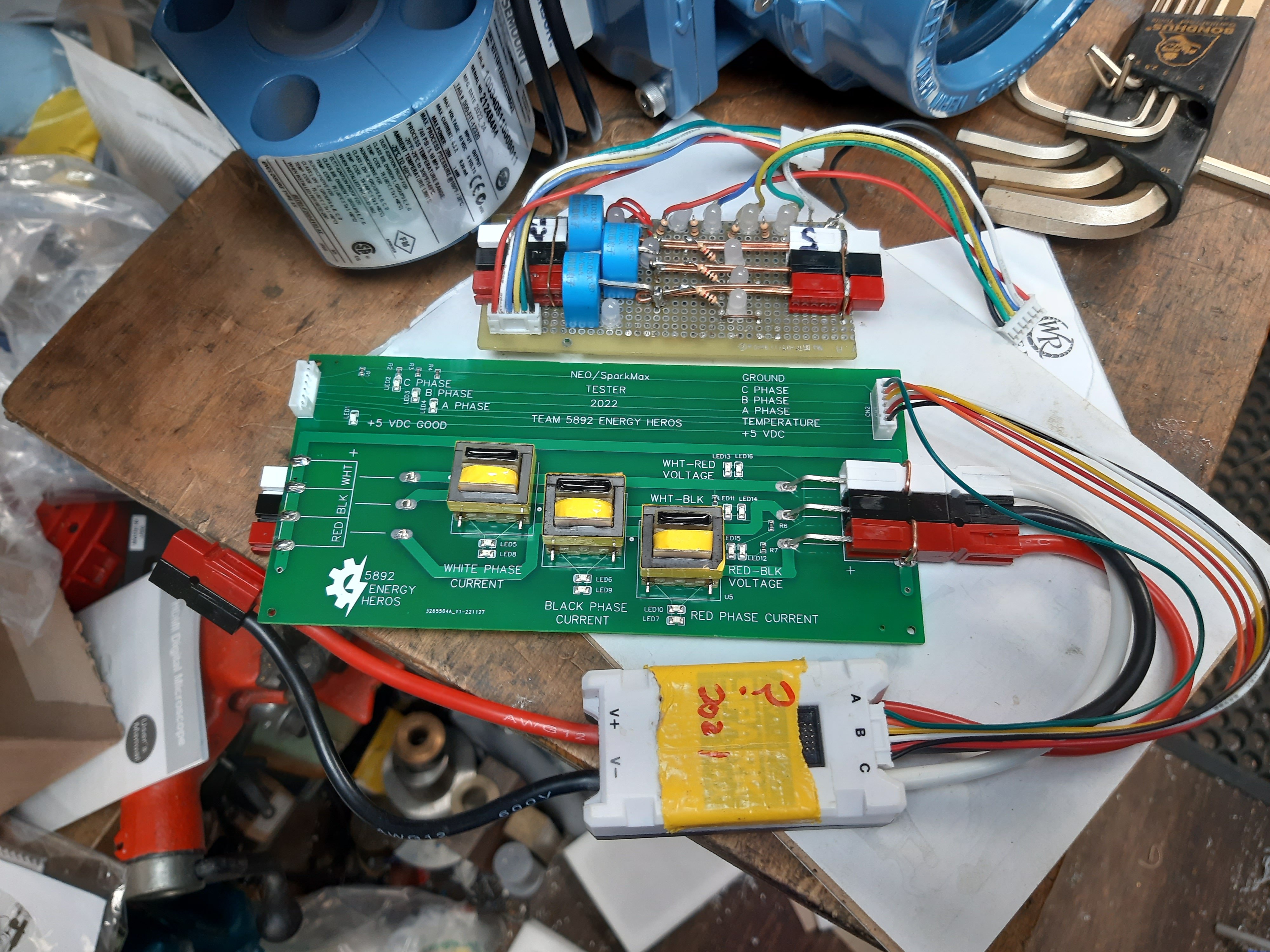

Any chance I could GET that NEO with the internal connection between the windings and the sensors? I’ve been working on a NEO/SparkMax testing board for a couple of years and I’d like to see if I can dream up a way to test for this failure mode.
Shorts in the windings are also VERY difficult to test for with normal test gear. The best way to identify them is to spin the motor (ideally with a drill). A good motor has very little drag, a shorted motor has a LOT of drag.
A shorted motor will show high current and will run slower than you expect it to due to going into current limit.
Here’s the current state of the art:
I have an idea to add something like “high/medium/low” current indication. And, now, I need to come up with a “short between windings and sensors” detection. That one needs thought, as I don’t want to go and create a problem while trying to FIND a problem. If anyone has ideas on a slick way to do that sensing, I’d love to hear it!

Follow the thread linked above for the motor tester if you want to add suggestions!

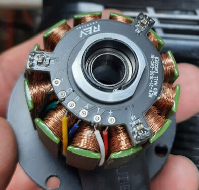

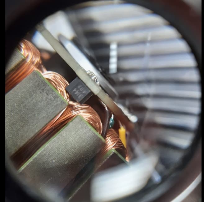

Update: I did a continuity check on the encoder wires, and there is indeed a short between the white encoder wire and the 3 motor power wires. Per Rev’s documentation, this is the analog temperature sensor, which I suppose has shorted to the motor windings
When I look at the hall sensor board on the NEOs, it looks like the only thing that you can really short to the windings is the temperature sensor:
You can see the T wire (white) with a trace leading over to the right, to a via. There’s another via just to the right of it. I’m pretty sure that the temperature sensor is underneath the board, probably surface mounted and looking down at the windings. It might be raised above the board., however, it doesn’t seem to be a through hole mount. Unfortunately, I’m two states away from my shop so I can’t actually photograph the important bits :frowning:
Not sure if that even seems like a reasonable trade-off for more accurate/ timely temperature measurements. Hopefully this is something they can adjust.
