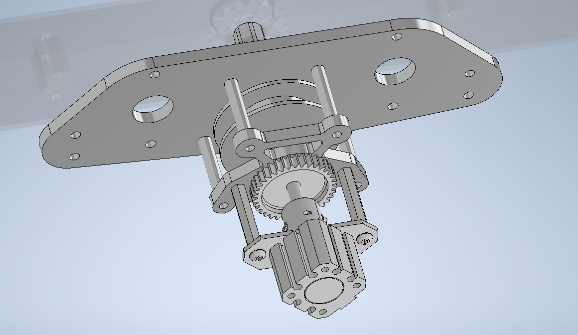

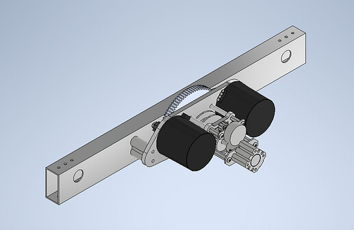

I have designed a 2 NEO PTO gearbox for a drivetrain with 6" wheels that I want to make in the offseason. The shifter has a spacer and a machined aluminum pulley on it. The pulley would be used to wrap string to extend ‘stilts’ for a HAB climb. Feedback would be greatly appreciated.
Two things that I see from a quick look:
  1. When you shift to climb your wheels will still be engaged. Depending on how your climbing system is set up that could be fine or it could be a big problem.
  2. The pulley is only supported on one side. If you’re lifting a whole robot’s weight through that pulley, you really want it to be well supported, otherwise it will significantly bend.
Definitely an appropriate use of PTO, provided you resolve Ari’s issues.
Not being able to see the grabcad, what is your reduction to the wheels? What are your reduction and spool/pulley diameter for the climb? How heavy is your robot?
The reduction is 84:9 and the pulley diameter is 1.5. @AriMB The pulley is supported on the other side by this 1/4" plate. There is a bearing in that plate behind the large encoder gear that supports the other side of the shifter.
I see that, but I’m afraid the whole pulley, plate, and spacers will rack when put under the kind of forces you’re talking about. Ideally you’d like to see that bearing plate supported more significantly, and in a way that keeps it from parallelogramming.

I mean, wouldn’t you have the same concern with the mounting of the whole gearbox then? Both the gearbox and the secondary plate are mounted by 4 8-32 screws with either aluminum or onyx spaces around them.
The front plate of the gearbox is (assumedly) mounted solidly to the chassis. The rear plate, on the other hand, is cantilevered a few inches off the chassis and only supported by 4x 8-32 screws. With the forces on that pulley so high, I’d be afraid of the cantilever bending.
If I ran this in season, I’d probably include standoffs across the width of the drive base (from gearbox to gearbox) to support that climb cantilever from the other side.
Would it be better if I changed the support for the secondary plate to three 1/4-20 bolts instead of four 8-32 screws? I am using 4 standoffs with 8-32 screws to connect the gearbox to the drive rail right now, should I change that?

It looks like the wheel is going to be on the other side of the chassis tube. The weight of the robot on that wheel will apply a twisting force on the standoffs that attach the big plate to the chassis tubes. Those standoffs are placed very close to each other. The section of chassis tube supporting the standoffs will have a hard time resisting that twisting force and may buckle.
There isn’t much material in the small plate and it may deform under force too.
The standoffs are actually one standoff that will be 3d printed. I can enlarge their size if necessary.
They really need to be spread further apart in the vertical dimension
