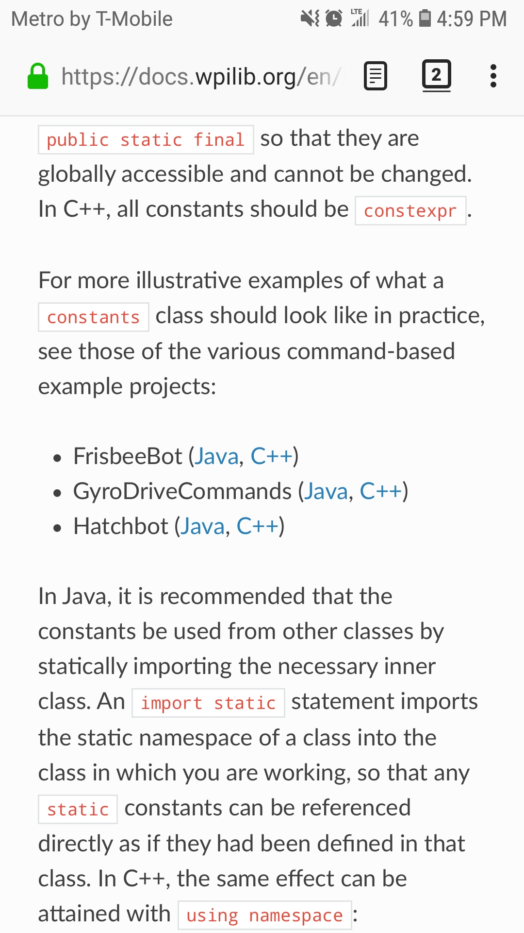

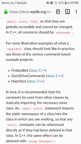

On
Gives links to some example projects.
