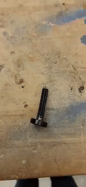

This is an odd one. This shaft came out of our wcs swerve drive module.
Looks similar to the failure reported here earlier today:
here it goes again…
Sounds like the laser weld is not quite what it should be.
ezgif.com-gif-maker
This happened to the Falcon on our intake this past weekend… The Falcons have been unharmed in all these but I’m really starting to question the claims of not needing to support the end of your falcon shaft with a bearing.

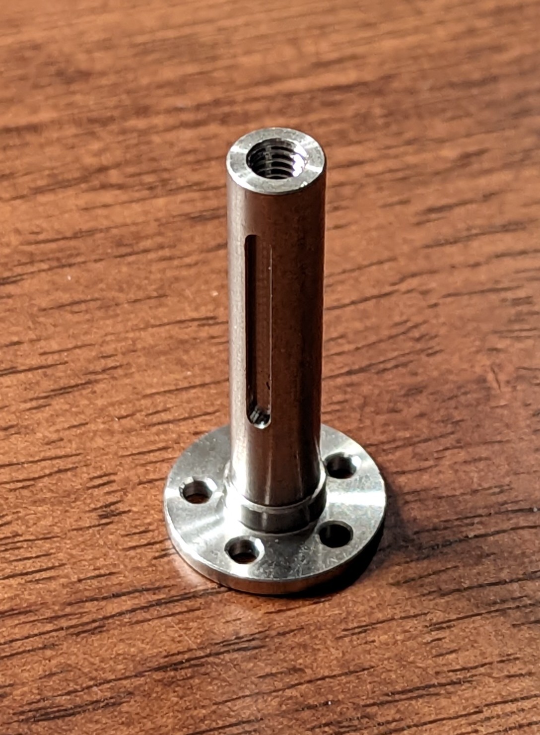

This is reminiscent of the KOP BaneBots planetary output plate failures of 2007. Here’s your fix https://www.thethriftybot.com/bearings/8mm-Keyed-Motor-Output-Shaft-p157387731
Can you confirm these shafts are a single piece of machined steel? If so we’ll definitely be making the switch
Almost certain they are, but @Ryan_Dognaux should be able to confirm whether or not fairly easily.
They are indeed. Disclosure: I work with Thrifty.
Yep, they’re solid stainless steel.
We’ve also recently updated them to include a 10-32 hole at the end of the shaft. Just need to update the product listing here with new pictures and an updated CAD model.
