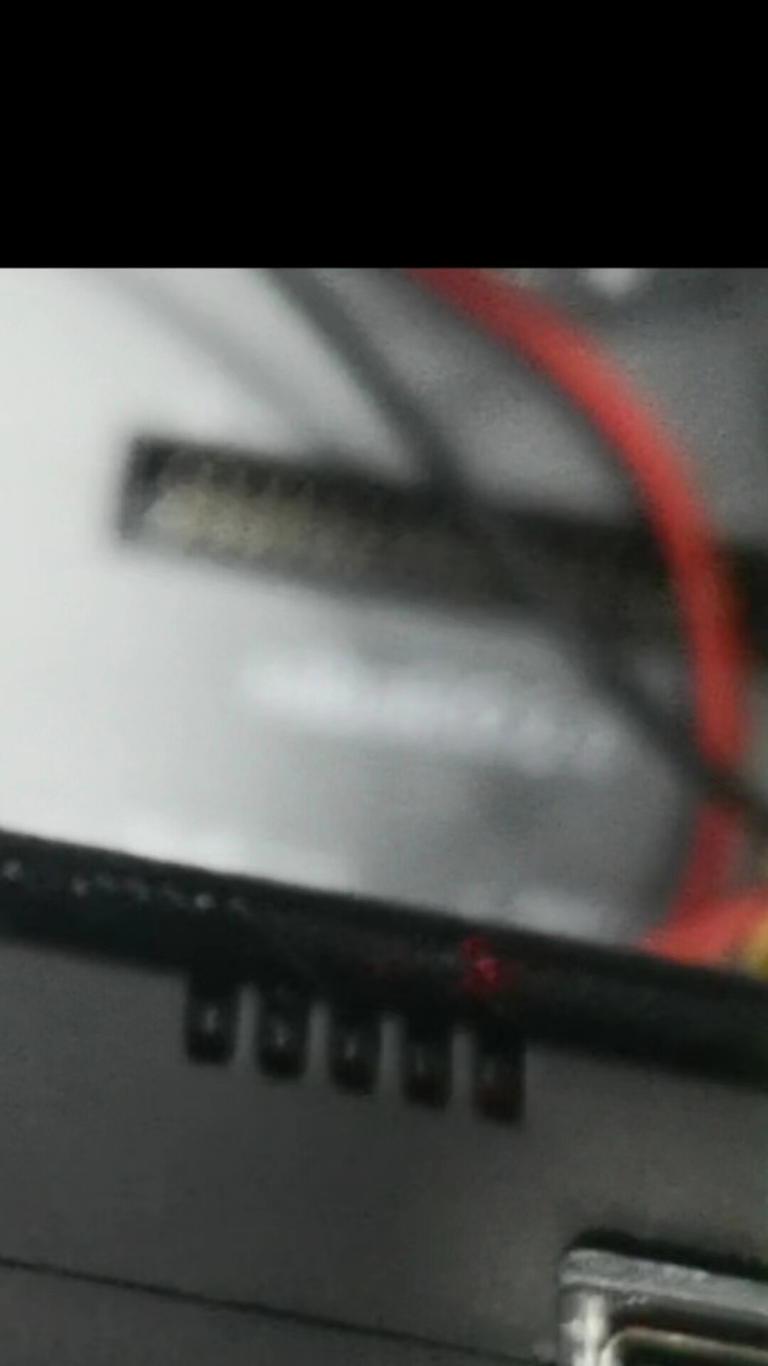

I also noticed that we seem to have some kind of little red light on inside the limelight, is this normal? Or is this some sort of fault light or something?
