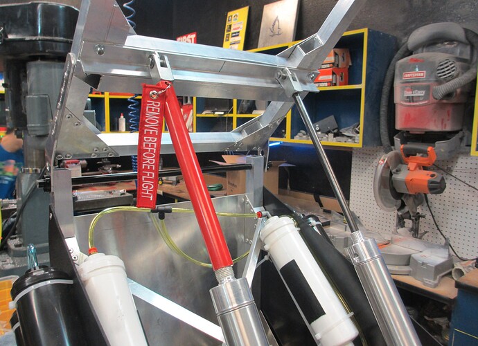

We have a pneumatic firing system as well. We designed a mechanical lockout that does not violate any rules. It is simply a metal bar that goes through 2 eye bolts in the frame. The bar keep the arm from firing even if we hit the trigger while it is in place. We forgot a few times with the practice bot. It makes a dull thud when it’s fired with the safety on.

In general, this is a good idea anyway. Both us and our alliance partners (1126) this past weekend had ridiculously powerful shooters. Both also had a mechanical lock in place for carrying the robot in a stored energy configuration. Whether it’s just a steel bar through two eyebolts holding back your catapult (20) or a thick metal pin that holds back a powerful slingshot (1126), the stored energy should be somehow contained for a worst-case scenario.
That being said I know exactly what you mean. Can the regional require this since it is not in the official rules? I’m not sure that’s okay.
Ours is simply a loop of high- strength sailing line with a carabiner on it. Loops around the catapult, frame of the robot and back on itself. Giant orange streamer attached to remind us to take it off.

Small-picture: Ratcheting tow strap looped around? 4901 uses one to fine-tune its release point, but a second one could easily cinch down and prevent firing.

We figured that we would be asked to have a safety lock on the robot because of the safety rules. (And were worried about moving it without one even though it is very difficult to accidentally release our shooter.) We used a steel shaft through holes on the robot frame, but at least a couple of teams I saw used rope and carabiner or bungee cords. The inspectors at Crossroads were helpful with suggestions.

Here’s our simple interlock for a pneumatic launcher: PVC piece that clips over a cylinder rod to keep it in an extended position, so that a dry fire results in no movement.
