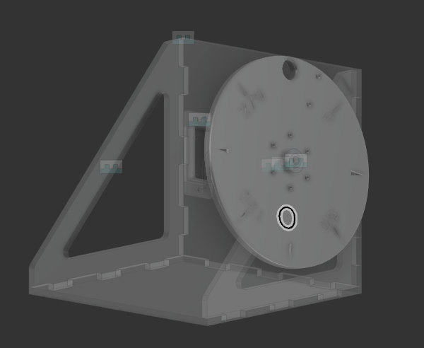

We are working on building a series of bench top elements for programmers to work with. Elevator, Flywheel Ball Shooter, Pneumatic actuators. The first one we built is a “spinner”. This is the design in process for V.2
We laser cut it out of .25 baltic birch and some .125 baltic birch. It is powered by a a NEO direct drive. With V.2 we are planning to have:
  • Color Wheel on the back of the disk and a color sensor
  • Optical proximity sensor to find the hole on the disc
  • Hall Effect Proximity Sensor to find a magnet on the disc
  • A limit switch to find a depression in the disc
  • A can coder driven from a gear (4 turns of the disc=1 on the cancoder)
  • An LED light bar to indicate status back to the operator
    All the sensors will be mounted in a 1"x2" 3d print so we can swap them out.
I hope to have a few of these for programmers to work through a series of exercises of increasing complexity. The beauty of the spinner is imperfect code does not crash into anything, it just misses the target.
