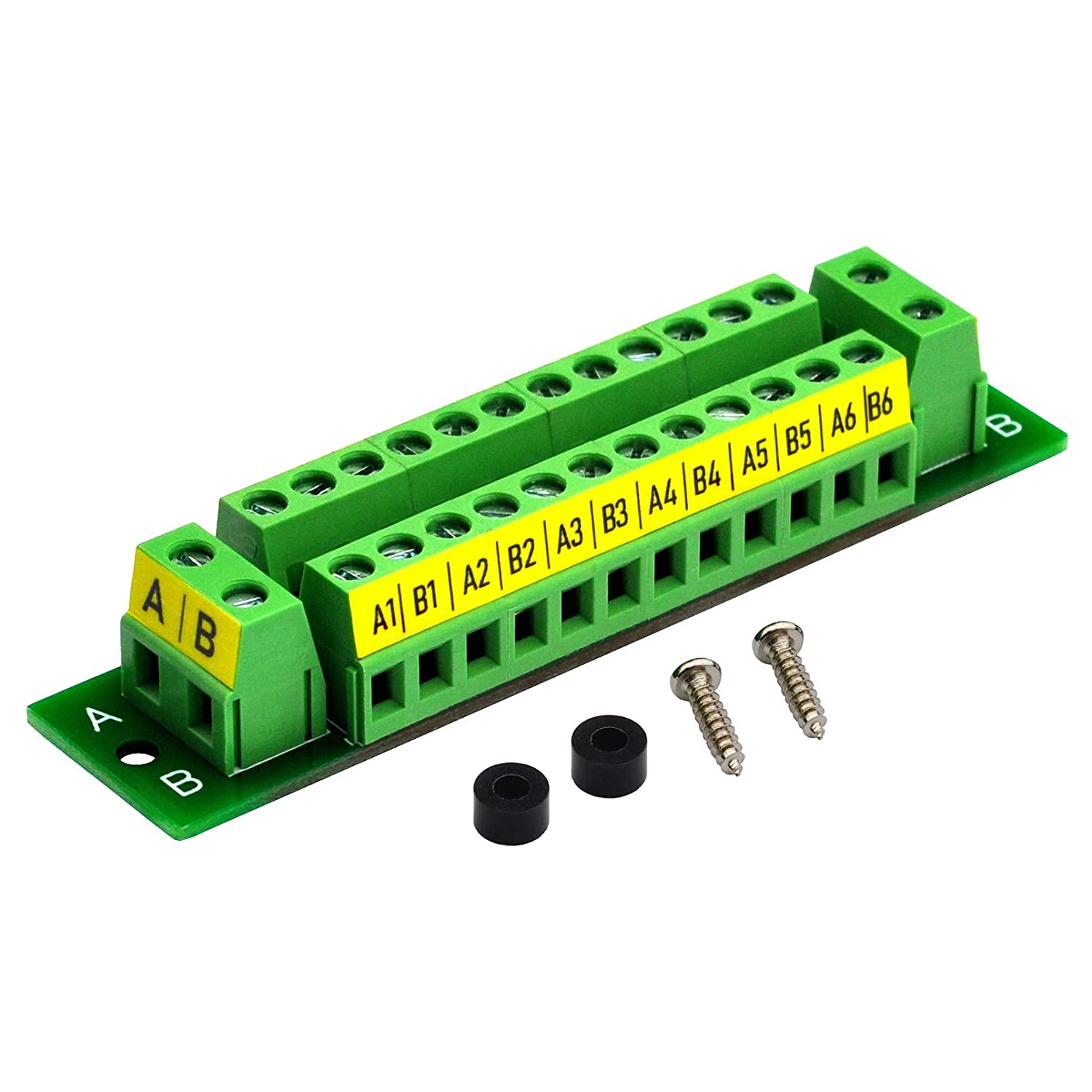

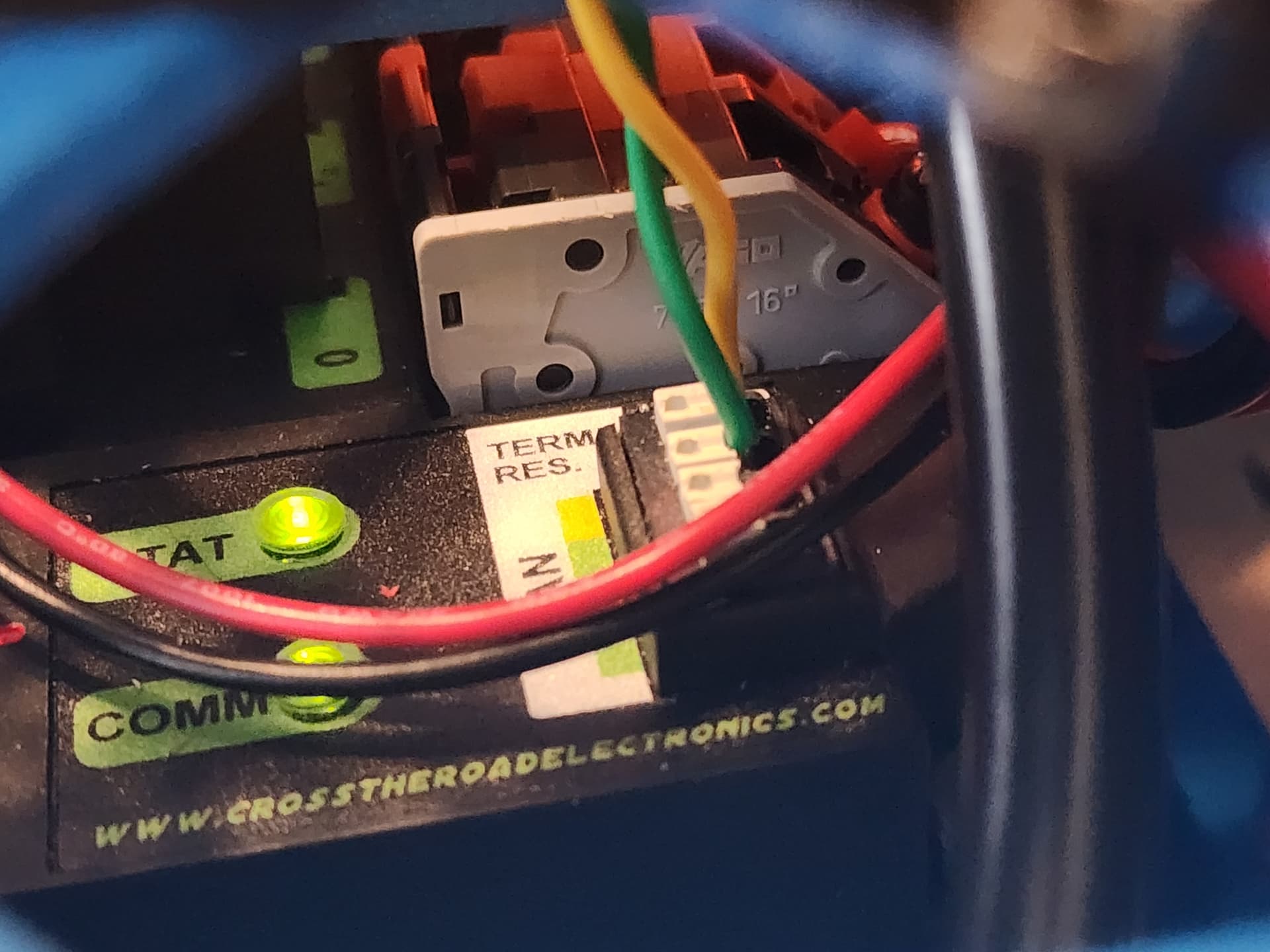

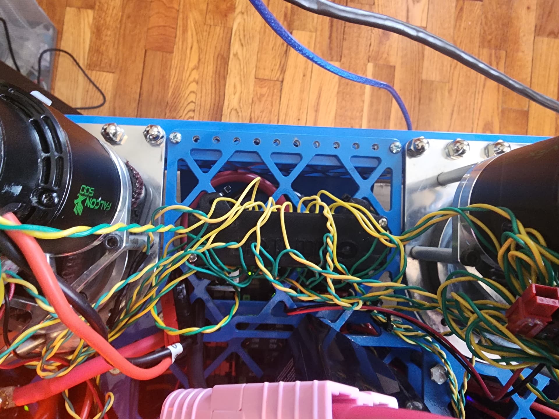

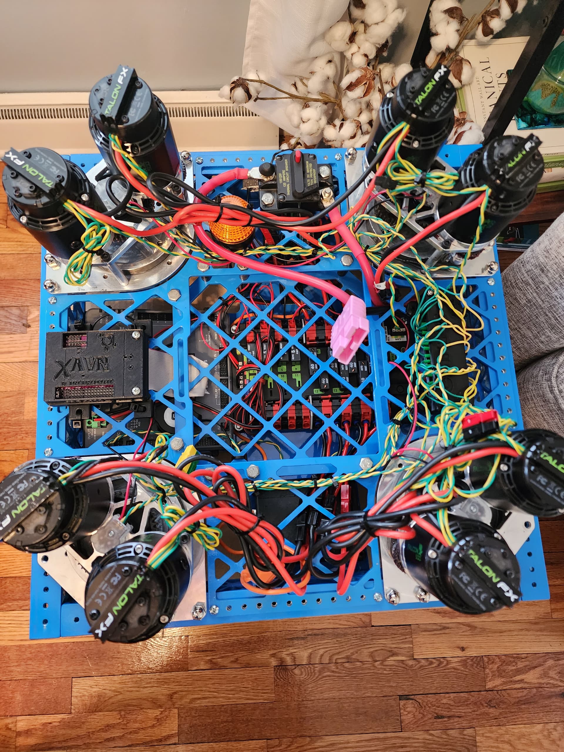

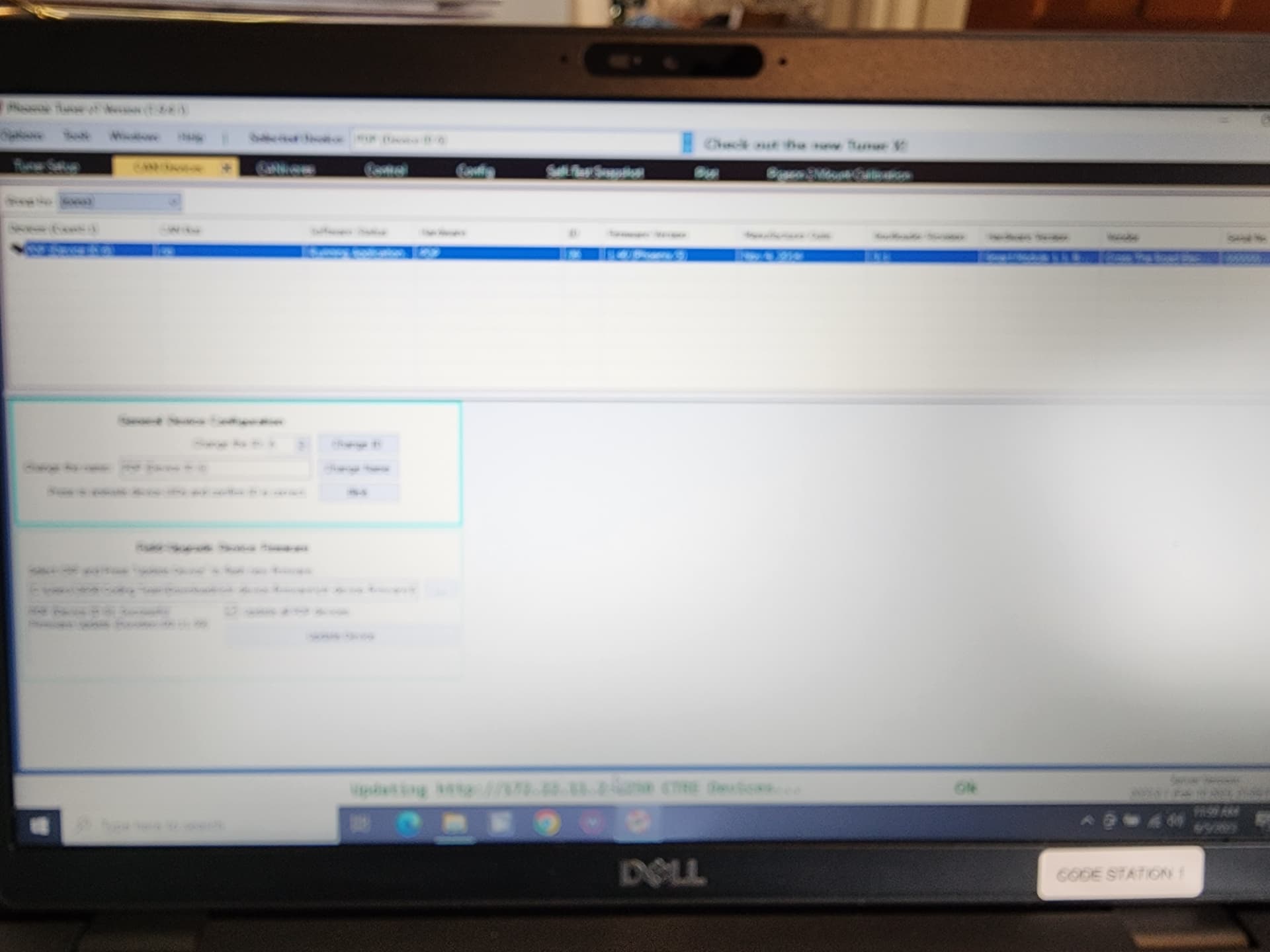

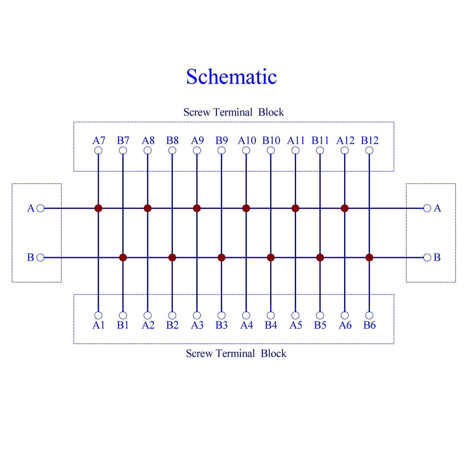

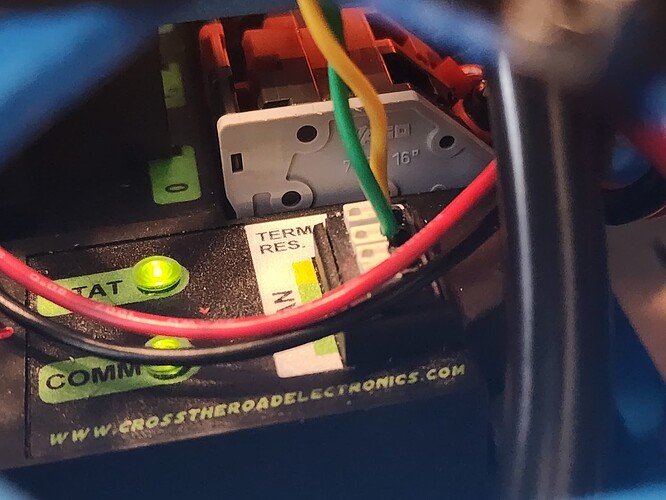

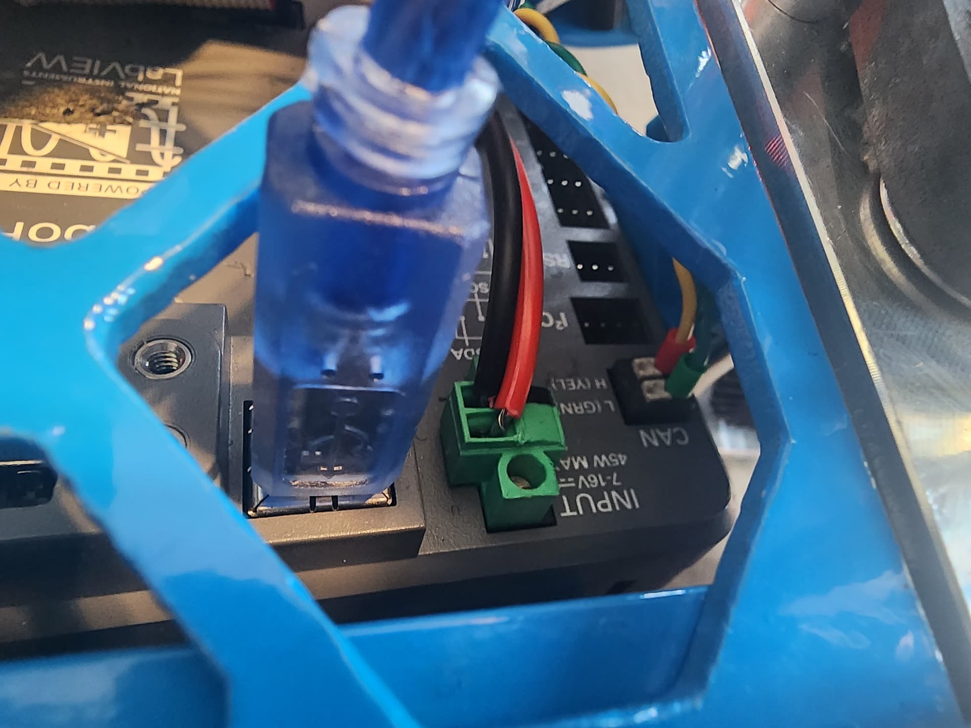

Our team just completed a build of the 2910 mini swerve and we are using a CAN Bus hub for all of the devices to connect to the system. Currently we only see the PDP in Phoenix Tuner.
Everything looks connected correctly and I reimaged the roborio just this morning.

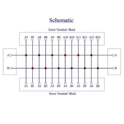

SO the can wires go from the RoboRio to the front of the hub. The two can wires form the back of the hub go into the PDP. I am connecting my laptop via usb to the roborio and only see the PDP.
From what the schematic and your pictures look like, your devices wired to the sides of the block aren’t hooked up correctly. You have all the yellow wires going to one side and all the green wires going to the other, while the schematic indicates that you should be alternating green and yellow wires on the sides, aligning with whichever color you wired as “A” and “B” on each end of the block.
@bobbysq Thank you for your response. I was able to see all can devices after rewiring the can bus.
