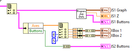

Hi Tom -
Thanks for the reply. The image below shows the Driver Station and the Dashboard. The driver station shows that the controller has Axes (0-5). The default Dashboard only responds to Axes 0, 1, and 2.
If I open a Dashboard Main.vi, I see the Joystick Values that is broken out into the two sets using the Prepare Joy Data vi’s. But I am at a loss on how to modify these options.
New photo by Daniel Sullivan

The image didn’t come through for me can you post it as an attachment?
You shouldn’t have to do anything to Dashboard Main unless you are using a special controller that has different axis that you want to map to the dashboard.
Are you possibly trying to show both sticks of a single xbox controller on the dashboard?

I think that I have not been on the forum long enough to have permission to post images. You can access the image here:
YES, that is exactly what I am trying to…
As I mentioned in my post, I was beginning to suspect that the Dashboard is configured such that the second joystick window expects to see a second joystick connected to a second USB port.

I now fully realize what you are trying to do. I have attached a picture and the dashboard main of what you wanted to do. I hope this helps explain things I apologize for misunderstanding your problem it seems like you were very close to solving it yourself.
Yes the default dashboard expects 2 traditional flight style joysticks. This year we actually used 1 flight joystick and 1 XBox controller so that is what I have coded for you. You can see on the image you posted that the XBox Controller has axis 0/1 as the left stick and 4/5 as the right stick. I am using pretty much the same code that is in the Prepare Joystick Data for Displays.vi but modifying it slightly. The index array function will noramlly give you the array elements starting at 0 for as far as you drag it down but in this case that was fine for the first two 0/1 but I needed 4/5 for the second 2 so I had to explicitly specify them (I really didn’t need to specify 5 as it was next in line but did for clarity).
I hope this helps!

As a quick mention, the joystick data is coming out in two arrays: double precision and boolean.
The boolean array represents all of the buttons on the joystick. The double is all of the axes you can use. If you know which 0-indexed button/axis you want to use from the driver station, you select that one using the Index Array.
That’s the heart of what Jason did to modify the base Dashboard. It’s a bit of a culture shock moving from LabVIEW to the FRC API. But, you’ll pick it up pretty quick if you understand LabVIEW.
