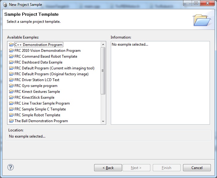

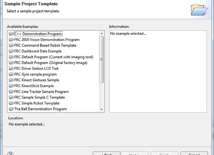

Where is the simple that includes the image stuff?
File->New->Example->VxWorks Downloadable Kernel Module Sample Project->FRC 2012 Vision Sample Project
That’s interesting. I have installed the latest update (rev2993) but I only saw 2010 Vision sample, not 2012??
The latest is rev3111, http://firstforge.wpi.edu/sf/frs/do/viewRelease/projects.wpilib/frs.2012_update_for_c.frc_update_3111
Ah, missed that. Thanks.
