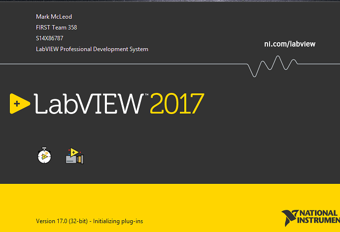

Have you installed LabVIEW from the DVD that came with your KOP?
That’s the first step.
The installation takes quite a while.
After the basic LabVIEW is installed, opening LabVIEW will give you the attached splash screen.
That’s only halfway to being done though.

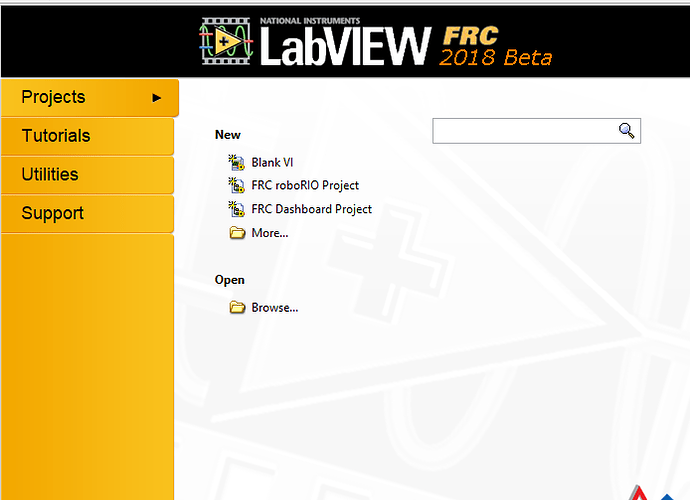

Once you get this you need to install the FRC specific Update.

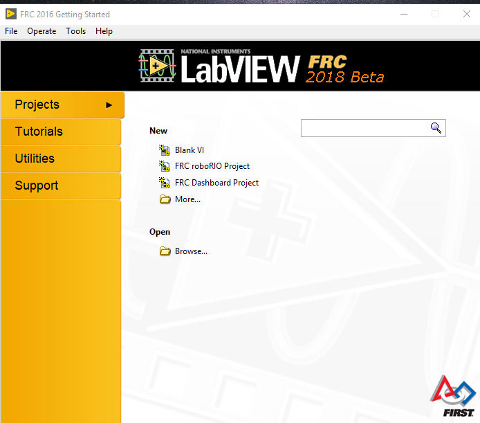

After that is done instead of the first splash screen you will now be seeing the second splash screen.
I’m not sure where the CTRE piece came into this given the discussion. Unless you have specific third-party hardware, you don’t need it.
You should only need to install the LabVIEW installation and follow it with the Update Suite.
If that’s completed, you can open up LabVIEW and you should see a screen that says FRC 2018 at the top of a darker yellow window.

When I open Labview, on the top I see labview in black letters and 2017 in yellow. Along with a big box on the left saying create project and right saying open existing. I believe this is the basic labview (not specified for FRC) correct?We also don’t have the WPI robotics library.
Correct, that means you’ve installed the basic LabVIEW 2017 correctly.

For that, download it. Unzip it. Run the setup.exe from that installer with LabVIEW closed. When it’s finished, open LabVIEW. The screen you’re seeing is in fact typical LabVIEW without the Update Suite applied.
