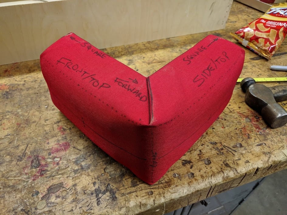

One of the biggest things I notice about teams that have a really nice looking bot, is that their bumpers either make or break the look. A robot will look 100x better IMO if they have clean bumpers with nice and smooth corners/fabric. With that being said, how do teams go about making their bumpers look so darn good? The specific style I’m referring to are bumpers with the seamless rounded corners (see 148, 254 etc). Has anyone made/found a decent tutorial for making these? I’ve got a general idea for how to make the frame and attach the noodles, but then when it comes to fabric/sewing, I’m at a bit of a loss.

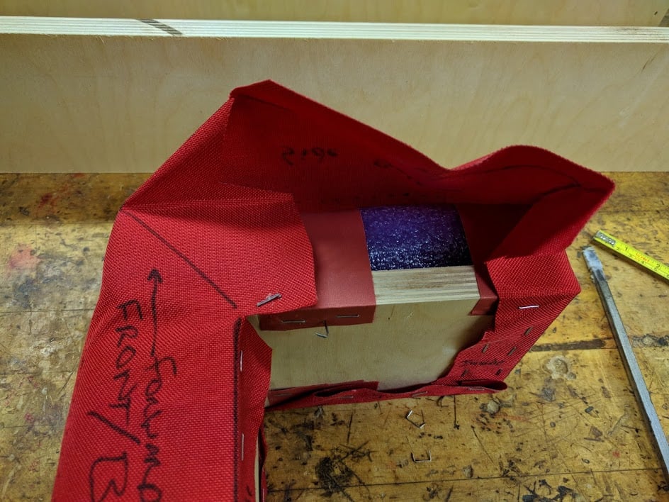

We get the clean corner look by sewing the corner gussets top and bottom. This year, we did full reversible bumpers that are also sewn vertically in the middle of the bumper. This is necessary to get a clean look if your bumpers have corners, where the more common horizontal reversible system doesn’t work as well. Here’s a quick video from team 3476 that shows how they work. https://youtu.be/DlyujQaTLlA Admittedly, this is not as easy to do without someone who has good sewing skills, since the center seams can be a bit tricky, but it really does let you change bumper colors quickly and not have to carry around extra bumpers or covers. Our board is seldom visible above the frame, but we still paint the back (usually black) and wrap the fabric around it so that there’s no visible raw wood.

We make decent looking bumpers, and the biggest “one neat trick” that I know is to clamp the bumpers tightly to a table, canvas side down and compressing the noodles slightly, before stapling the fabric to the plywood. This way when you unclamp the bumpers, the noodles will expand back up to size, keeping good tension on the fabric.
The next most important small detail is how you handle bumper corners. We like to put a small vertical noodle piece in the corners, but some teams prefer to bend the noodle around the corners. Both options produce good results, but we find it easier to fold the fabric corners with the vertical noodle method.
