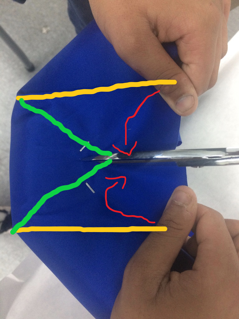

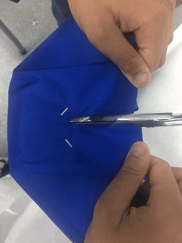

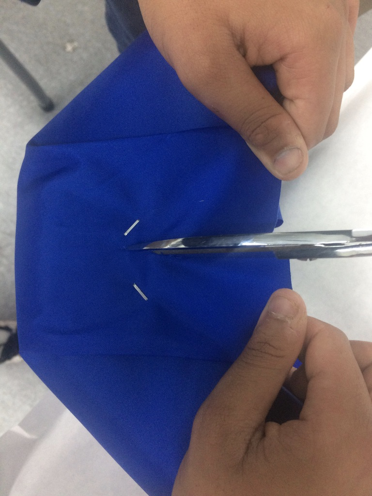

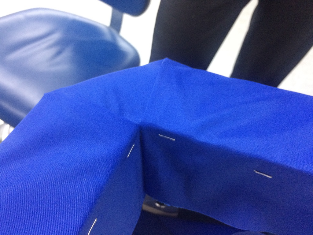

How do you go from this step:
To this step?
In the first image it appears the fold is on top of the corner, whereas in the second one it looks like the fold is over the edges.
I believe you invert the fabric in that area (tuck the flap under itself if that makes sense).
I actually asked @Torrance this same question.
I dont see how you went from
to
with just a 45 angle cut.
His reply:
Good catch. I did not picture how to do the fold very well.
Once you cut the flap into two flaps with scissors or an exacto, you need to fold one of the smaller flaps over the top of the wood, towards the corner, to result in the fold you see in the finished picture.
In the picture of the student holding the flaps, imaging that student held the bottom right corner of the lower flap as they are currently doing and then move it to the top right corner of the other flap where their other hand is. They’d be folding the flap over the wood, with the lower visible staple kind of acting as the fulcum at the pivot point of this fold. When you do that you end up with a nice crease that runs from the noodle corner parallel to one of the pieces of wood over the corner of the wood connection and down onto the wood face where you can staple it.
My follow up:
After the cut, fold in like the red arrows. The yellow edges become the green edges. But what happens to the 2 staples? Just fold over them?
Answer:
Yes. The stapled get covered by the flaps and so aren’t visible. After the folding, the flaps need to be stapled to the vertical inner surface of the wood.

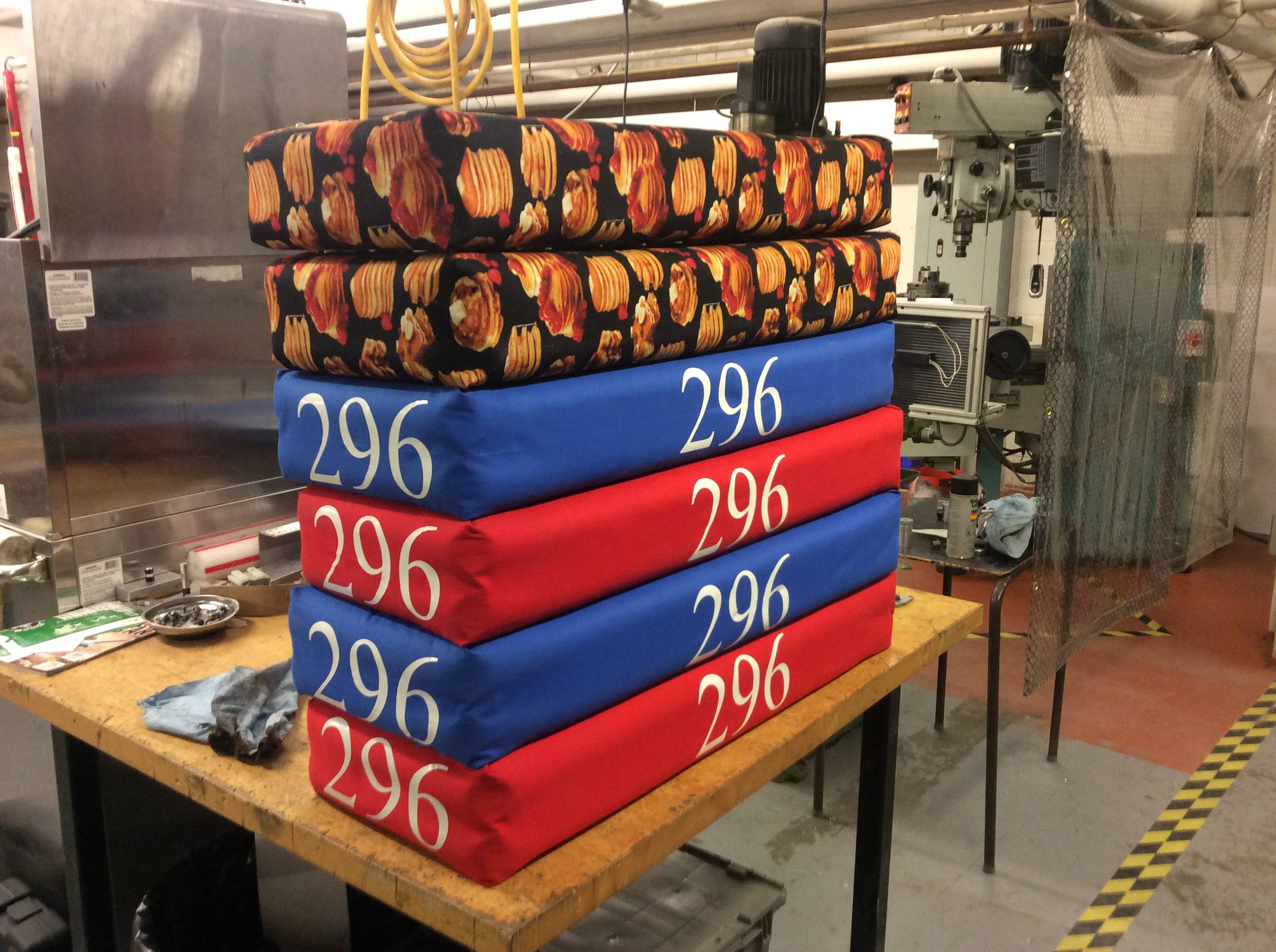

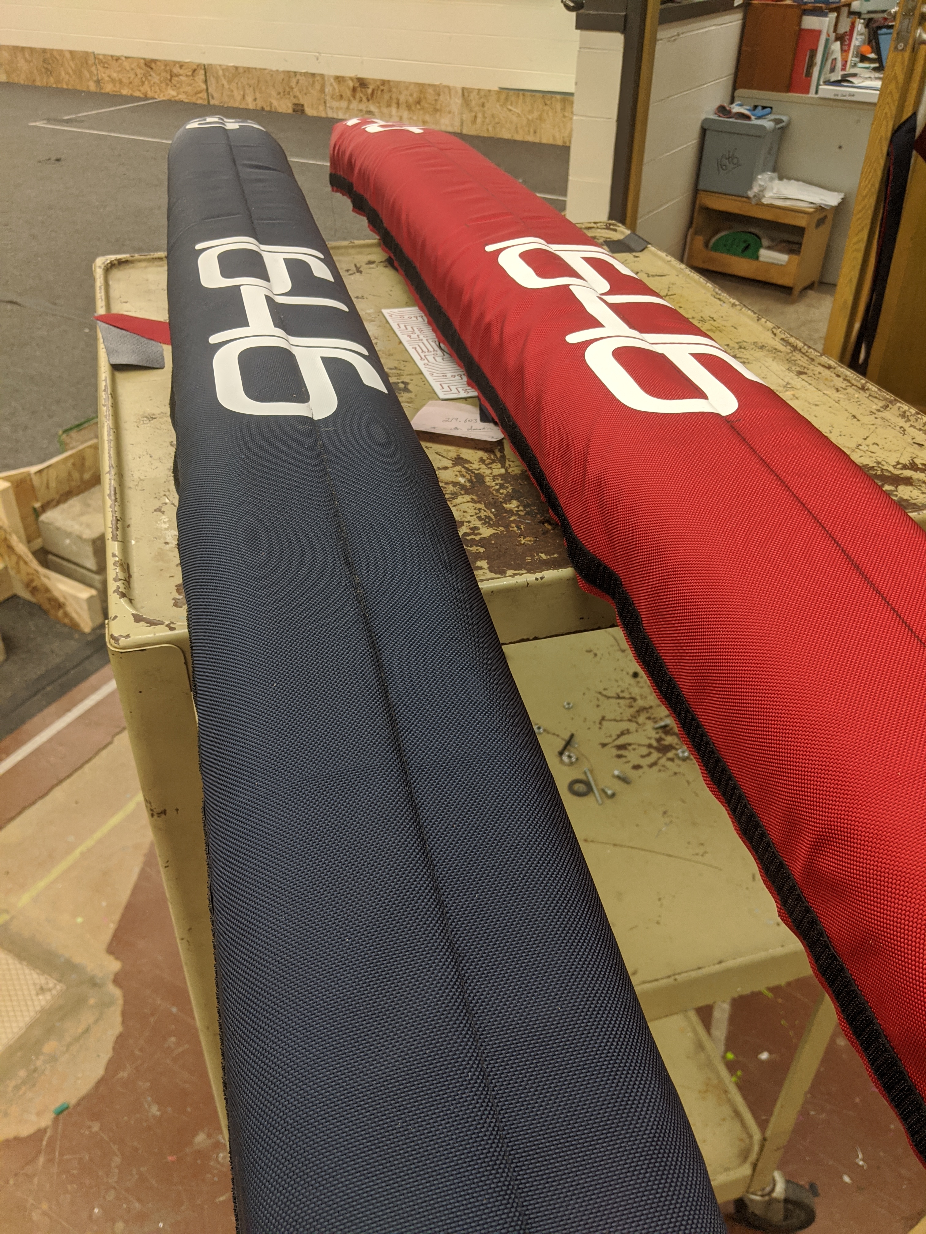

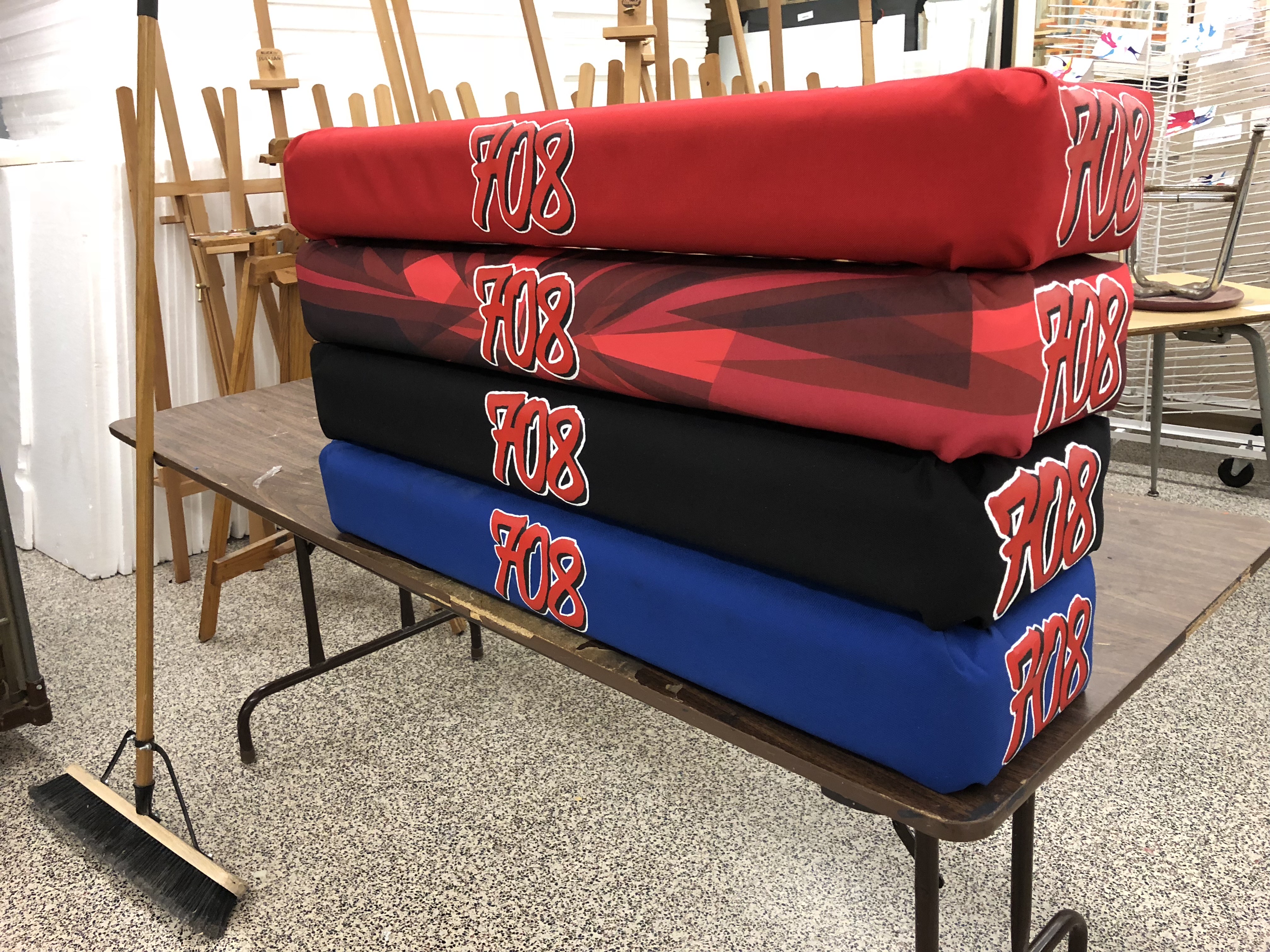

We have always made 2 sets of bumpers (at least)

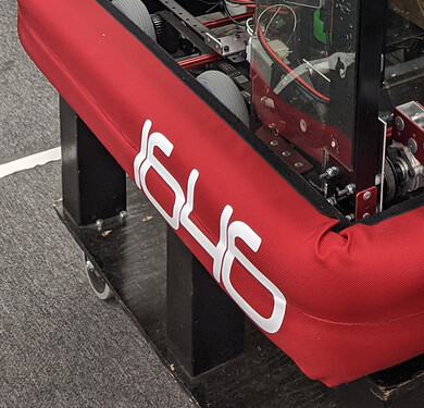

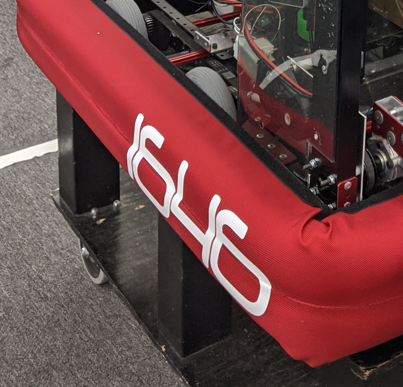

Where did you get the numbers with the special font and color?
We created the stencil ourselves from one version of our logo and hand paint them on the bumpers. It’s time-consuming but looks nice in the end.
We have been doing reversible for many years. Once we pass inspection, they’re bolted on and they don’t come off until next comp. Heat transfer vinyl for the numbers, 1680D coated ballistic nylon fabric in red and dark navy.

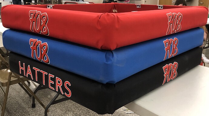

I like to think they look nice.
