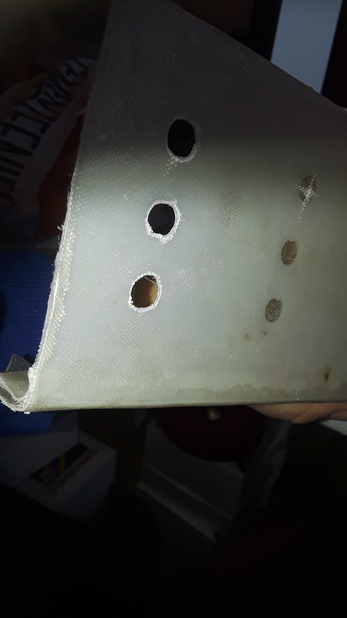

Yeah I am aware of that and am working on some things to minimize that. During construction the intent is to not really machine. The idea is to pre drill the holes into the wood blocks and/or 3D Print them in the plastic and then glass over them and then you just wait a tiny bit to when it starts setting up and is still very tacky but set up enough to not move around no more and cut the holes out with a knife you can even put some masking tape over it and you get as much in particles or less as when cutting the cloth this was done on theses holes
The thing we learned from this part is that you need thickness to get stiffness the bottom which has 5mm spacers in it was pretty stiff while the plate with the holes was about as flexible as a FG fishing rod. here is another shot of the “stiff” part
It all started out as a 1mm wall thickness 3DP part (printed with a .8 nozzle. The holes cut with the knife are not that nice so currently we are making them bigger and then “plug” them with a properly sized plug or if its wood use one of the inserts that are used in the bumpers. On foam Polyurathene Floor covering works nice but unfortunately does not stick well enough to ABS/HIPS/PETG etc so now we are also testing latex. Now that works well with FG screen which might be strong enough for things inside the robot like a battery box or a shooter or ball pickup/conveyor etc future tests will show in which case at any time it could be cut with a box cutter. if absolutely necessary. The drive base will have some woven roving or 8-10oz cloth and resin. In the picture on top you see that the holes are evenly spaced and our current system works on that. so the plan here is that everyting that mounts to the frame is based on those hole spacings so that in the pits hopefully there is no machining and cutting - maybe some gluing if something breaks.
