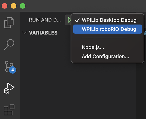

This is likely one of three problems:
  • You aren’t actually deploying to the robot, e.g. you’re deploying to desktop simulation. Check on the “run and debug tab” in VSCode.

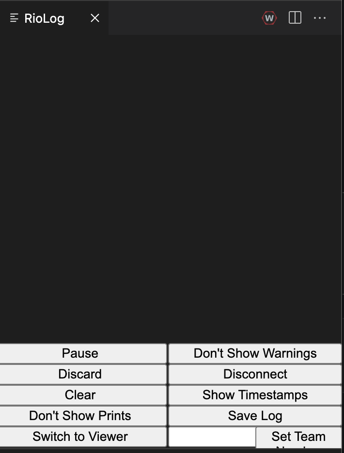

  • A build failure prevents deployment. Have you checked the “Terminal” window in VSCode. Can you post a screen shot of the last page of a successful deployment?
  • Your robot code is crashing. You should see a stack trace in the Riolog.

In the Driver Station, you can open up a console window (click the little gear to get to a popup menu with that option). You should be seeing output there where it’s trying to start your robot program and most likely immediately crashing. In the crash message there should be a stack trace showing where the problem is.
The console constantly repeats this:
Warning  44004  FRC: The Driver Station has lost communication with the robot.  Driver Station
Warning  44002  Ping Results: link-bad, DS radio(.4)-bad, robot radio(.1)-GOOD, roboRIO(.2)-GOOD, FMS-bad FRC: Driver Station ping status has changed.  Driver Station
 Info roboRIO: Game data update “” received by Robot
 Error: Could not find or load main class frc.robot.Main
 Caused by: java.lang.ClassNotFoundException: frc.robot.Main
