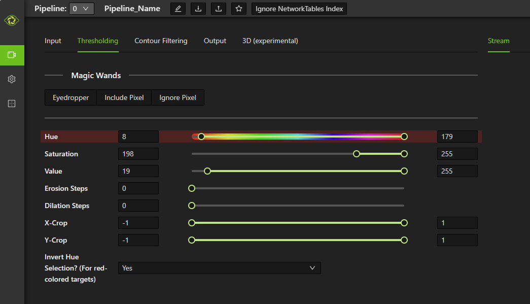

We can’t do the ML cause we don’t have the money hahaha. Does you or anyone know some configuration to this panel in the limelight software?
There is a guide on the thresholding page from Limelight along with the rest of the documentation for it. These official sources are gonna provide the best information of how to use their product.
There isn’t a magic set of numbers we could tell you that will work for you to see a Note it’s something you tweak in real time until it’s filtered to just the color you are looking for and then lock those values in. More than likely you will have to calibrate at the events as your lab lighting is going to be different than the field lighting
