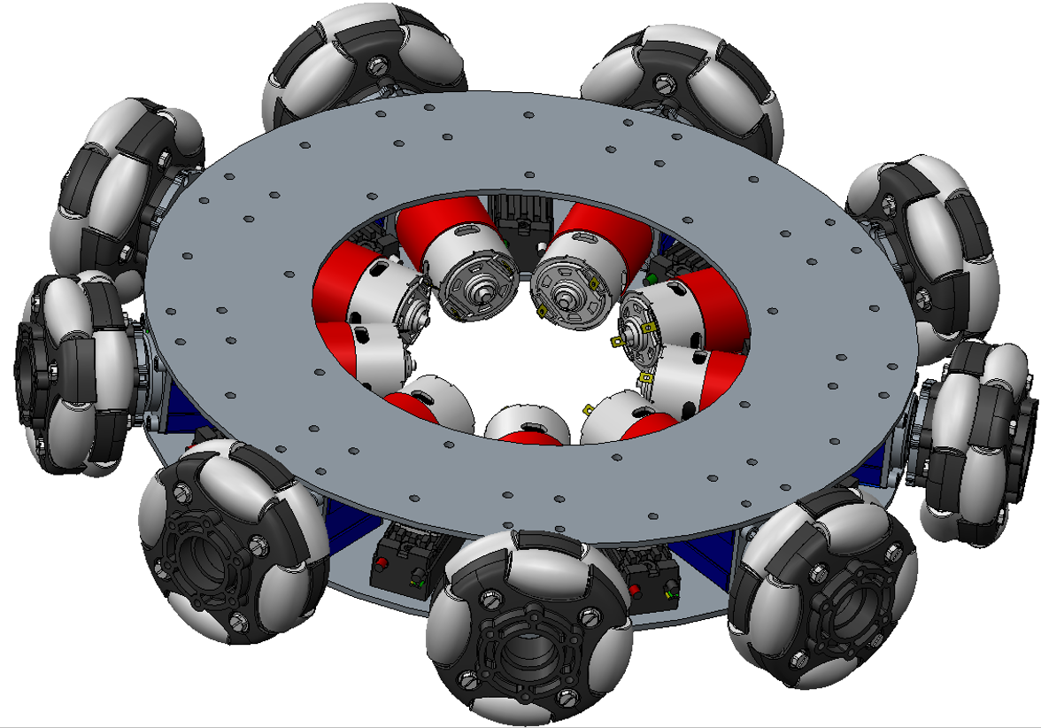

So this isn’t my idea but one of our team members brought this up. What would be the disadvantages of an “O-Drive”. Instead of an H-Drive where the module is in the inside, there are wheels on all 4 sides of a robot. So essentially the h portion of an h drive is moved towards the outer edges.
Extra motors, extra weight, can’t have an opening in the front for game pieces. What’s the benefit?

More even power (and thus acceleration) distribution between forward/reverse and strafing.
Reduced need for a suspension to ensure strafing wheel contact
If you position wheels in corners, you can absolutely have frame openings.
I’d also question the extra weight characterization. You may well not need extra weight compared to an H-drive. And, heck, in certain configurations you could even use fewer motors as well.

Sounds like you are talking about a holonomic drive tilted 45 degrees

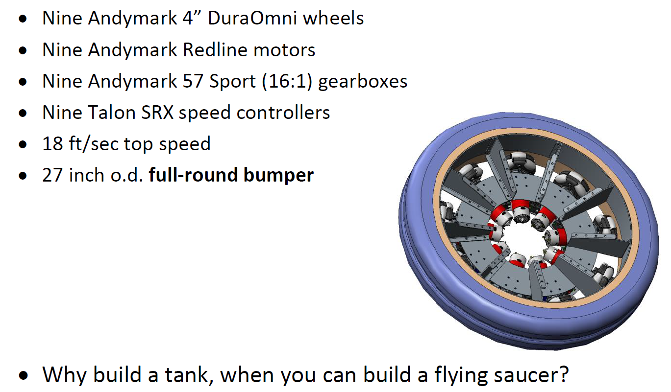

Don’t listen to the haters, this is the drivetrain of the future.
Slap some 4" colsons on there and you’ll have yourself one spinny boi.

What’s the benefit over a traditional kiwi/killough?
I would expect more traction since there are more than 4 wheels, although I don’t know if you will be playing defense any time soon.
