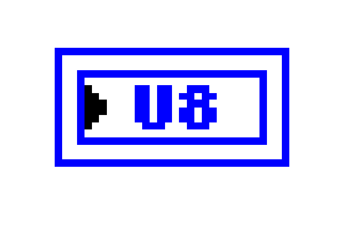

we are looking for the unsigned 8-bit integer with the arrow in the box with it. the regular one we have is just u8. we need the one that has (>u8) (the parenthesis are the box and the arrow the small arrow.) we don’t know how to make that or where to find that special form of the unsigned 8-bit integer. please help. :frowning: :frowning:

You seem to be describing the first attached picture below.
That’s called an Indicator.
How you get that depends on what else you have going on, but in general right-click on a U8 node or wire and select Create->Indicator from the menu.

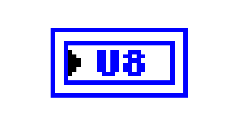

The Indicator might show up looking like the second picture, but it’s the same thing. To turn the second picture into the first or vice versa, just right-click on it and choose View as Icon.

this is the block we need. we cant find this block anywhere. how do we make it
ok we have it now we think. thank you all for the help. it was very usful. if we have any more questions we will post them here. thank you all so much
