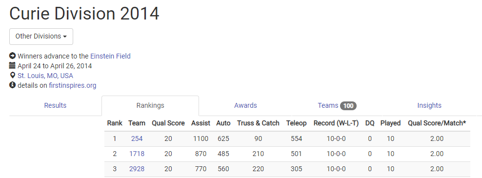

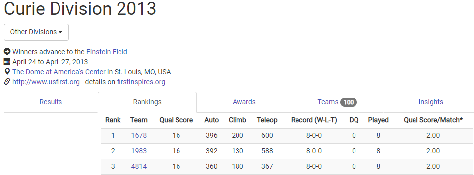

As for champs, there have always been 10 matches (Or as long as I’ve been in FRC). I would rather have 10 matches with large divisions than many smaller divisions with 12 matches.
