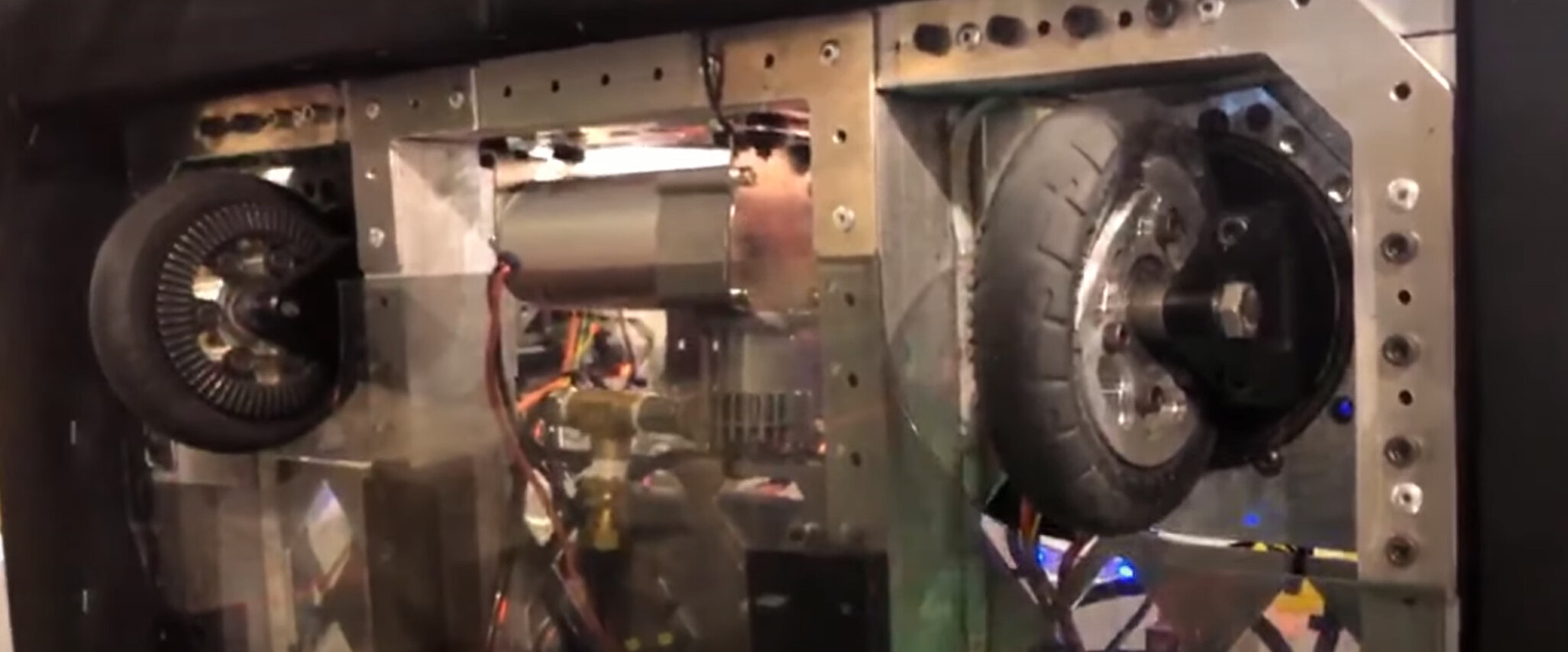

This has been pondered and even executed before:
It’s going to happen some year (& I know plenty are hoping it’s not this year :grimacing:), but when it happens, what are these all-terrain swerves going to look like?

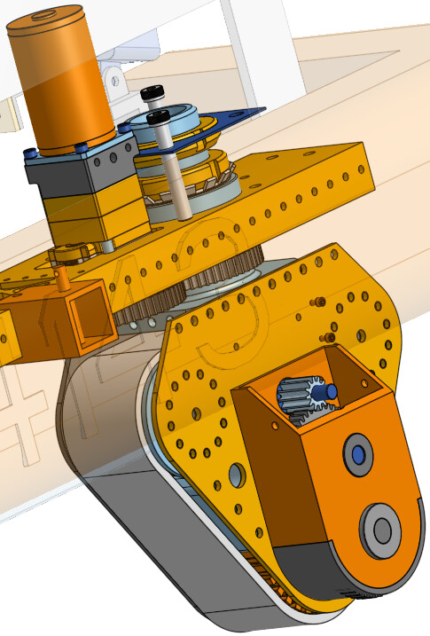

Also from 2016: 1533 Swank Drive

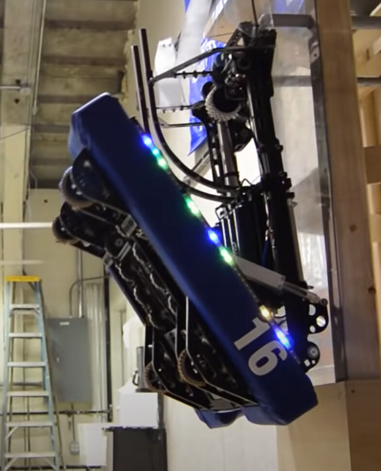

Team 16 also used swerve in 2016

If 2016 happened again, we would look hard at cranking out a 6" or 8" pneumatic wheel swerve module. Probably brushless motor in wheel with slip rings.

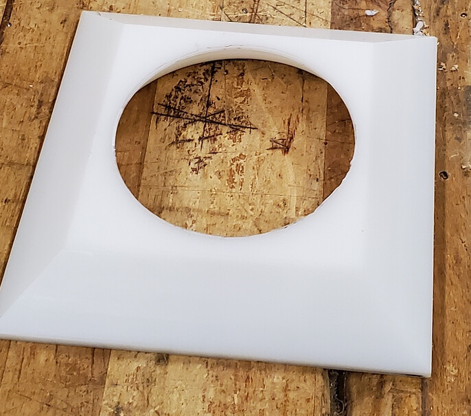

Amazing what some wheel guard ramps can do for swerve.
Those look like 4" rigid wheels. Bomb Squad was able to go over all the defenses, even the Rock Wall. We played them at Rocket City, but I don’t have pit scouting notes with any swerve module details.
This design worked together with a decision to only go over the defenses “forward”. There was no need to have ramps for going over the defenses sideways.
Some teams used much smaller, but 4-way ramps to help swerve deal with the relatively tame obstacle of the Boundaries in Infinite Recharge.

I was the mentor for the design team on 3419 that came up with the 8” pneumatic swerve in 2016. I’d do it again in a heartbeat if the game called for it, although I’d probably tweak the design a bit based on lessons learned that year.
We’ve also used 5” and 6” pneumatic wheels (just like those pictured above) when the field had a less severe obstacle on it. The big problem with those, though, is that you need to manufacture your own hubs. The geometry required is difficult (you need to account for the roundness of the inner tube, a place to put the tube nozzle, etc.). It is doable with 2.5 dimension machining, though, if you design it as split rims. We were actually planning on using 3D printed hubs for 2020, and they worked fine on our prototype robot, but they never saw a real competition because of Covid.

It will largely depend on the nature of the terrain. The 2016 terrain had a lot of variety, so it required a very general ability to handle that terrain. Of course you did not need to handle all the outer works if you did not want to. 1533’s swank drive mounted the tank treads about 1/4" above the carpet when we were driving on the flat floor. The treads would carry the robot over the terrain. The swerve wheels would, in fact, contact the terrain as the robot went over, but would not get caught. Many of the other concepts that year were also focused on making sure the swerve wheels did not get caught on the terrain. Those concepts would all work on many terrain types.

That Swank Drive is pretty sweet!
They ran it in 2012 also. Went to Einstein. Oh, and that alliance won.
I was looking again at 4143’s 2016 bot Sir Twerve’alot, and I’m wondering if anyone knows what kind of “tread” belts are used that are part of the each swerve module and make contact with the carpet? I think it would be interesting to design a version of this module with today’s parts (maybe Neo drive / Neo550 steer).
