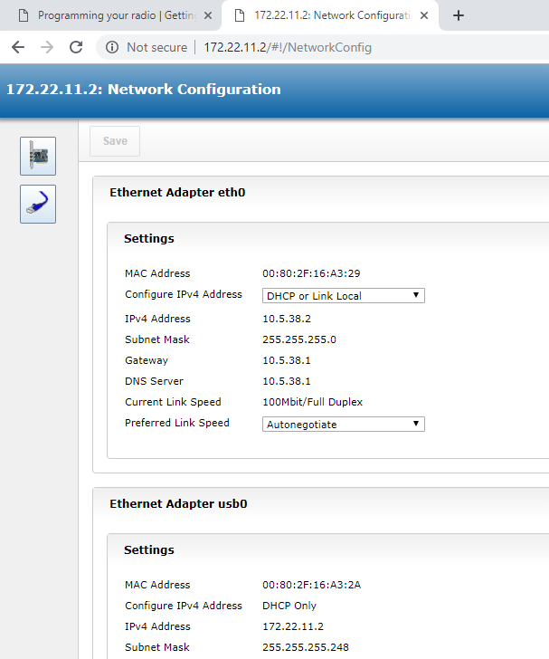

I’m having a hard time with the ‘FMS Lite’ option of Radio config utility. It looks like the DHCP server is still turned on in the Radio, and it’s handing out 10.TE.AM.x address to the roborio. This wouldn’t ordinarily be a problem but we broke our Access Point last year and the new AP won’t currently let me config 255.0.0.0 for the network.
I’m using the Offseason FMS 2018 - the latest that is available. I want to switch to Cheesy Arena for next year and invest in a managed switch so we can run a VLAN at our next week 0.
The FRC Radio Configuration tool, when run in FMS Lite mode, sets the radio to bridge mode and enables a DHCP server on the robot radio that is supposed to provide a DHCP reservation of 10.TE.AM.2 to the Robo Rio.
You may want to consider running a different DHCP server on your FMS LAN if your AP won’t let you set a class A netmask. There are several open source / free ones for Windows. Otherwise, you would need each team to set a static IP on their robo rio AND their driver station.
