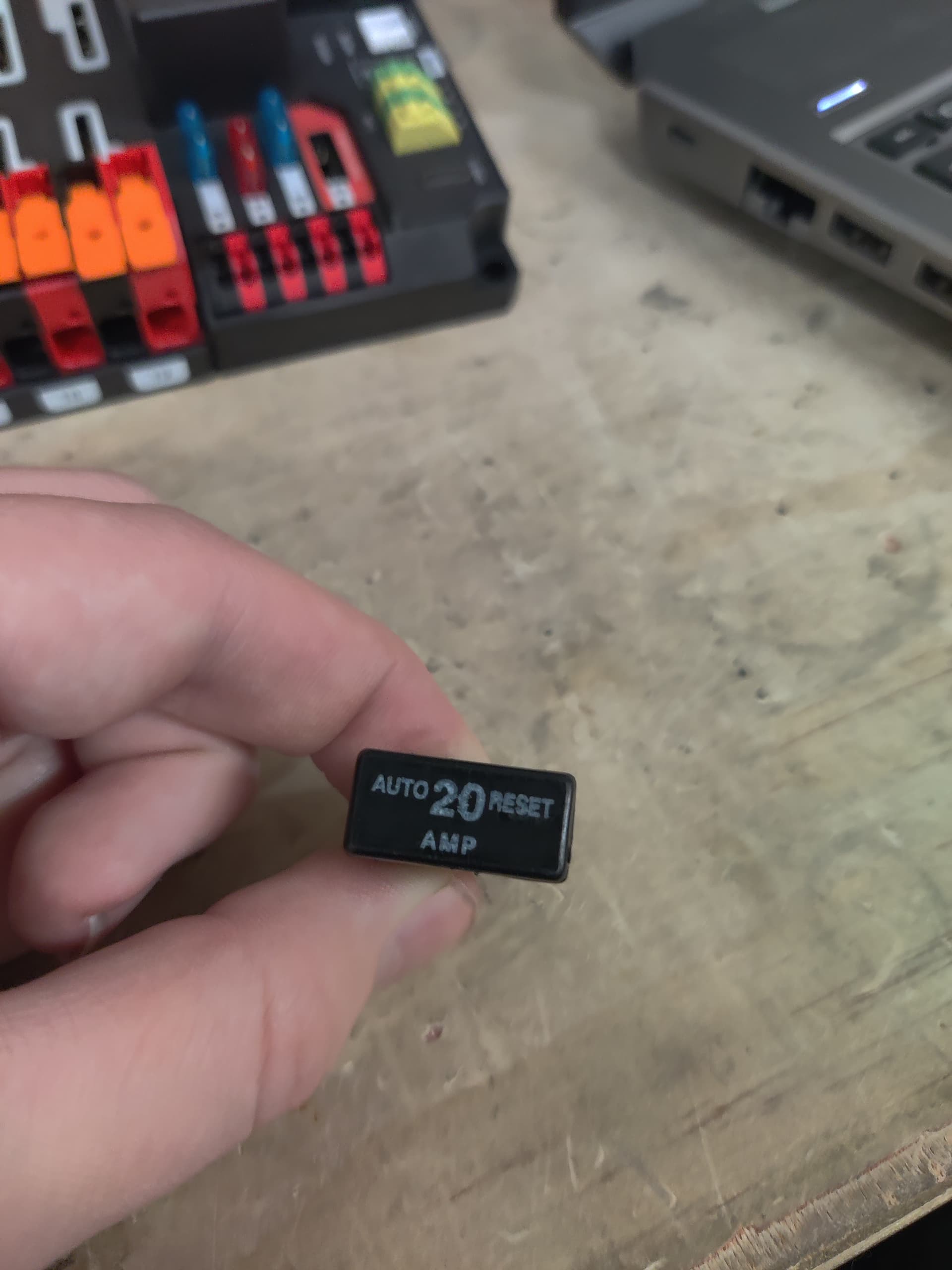

Old breakers on a pdh
Can I use these old breakers on a pdh, the prongs are to long is it fine if I cut them down to size?
You can use them unmodified. Do not cut down the tabs.
Some of the prong sticks out when we pushed them all the way down
Yes that’s fine. Don’t try to modify them by cutting them down. If the exposed metal is that much of a problem for you, you would need to either use a PDP instead, or acquire REV breakers (which IIRC also has a small amount of exposed metal on those prongs)
