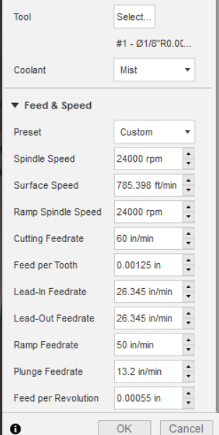

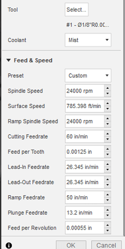

What speeds and feeds are you using? Do you have “leave material remaining,” checked? Are you doing any kind of finish/spring pass after the roughing pass? Is the diameter tool your CAM software says the same size as the one in real life?

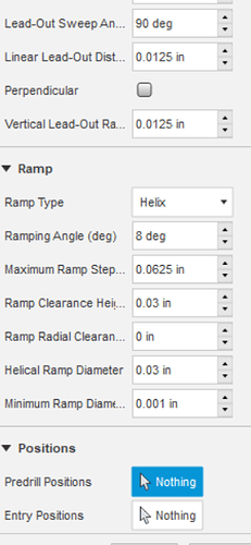

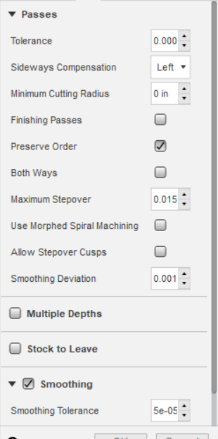

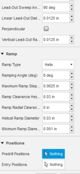

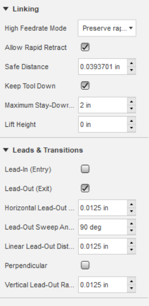

Here’s some photos of our setting choices in fusion for the CAM
![eee|248x500]
Sorry for replying so many times it wont let me upload all of them at once since i’m a newer user apparently.
And yes the diameter is matching that of the one in real life
No worries. Nothing sticks out at me here. Looks like you are not doing any kind of finishing, or spring pass with a very small tool (1/8"). My suggestion would be do do a finishing pass at the nominal size you are shooting for.

Can’t speak to omio specifically, but make sure your tool diameter is properly set. The description says tool #1,1/8" diameter, but then it says R0.00… (cut off).

0.015 stepover is very small for a .125 bit. Consider 40% (.05) instead. Double-check your safe distance, a value like 1/2" is more common BUT the omio may use the setting seen fir something else.
Lastly, find out what the “finishing passes” checkbox does, it may help here.
