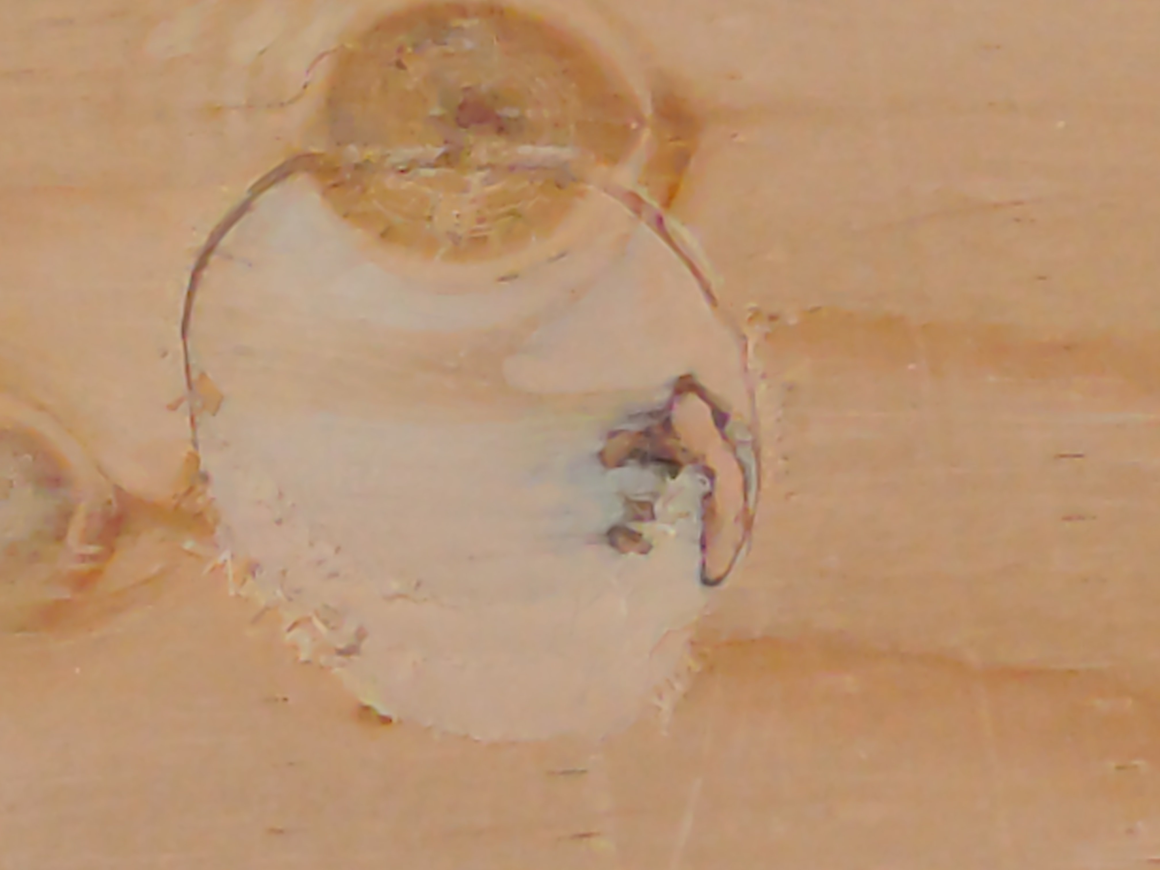

We’re trying to start by drilling a drivetrain hole pattern into wood first to get a feel for the machine in a lower risk/quicker setting than using metal. Whenever it tries to drill out one of the bearing holes, it has a lot of issues, driving to the left while making the hole to the point where it starts hitting the wall of the hole and making it very oblong. It doesn’t do this in the Fusion 360 sim. Is there a way to calibrate it somehow, or otherwise address the drift?

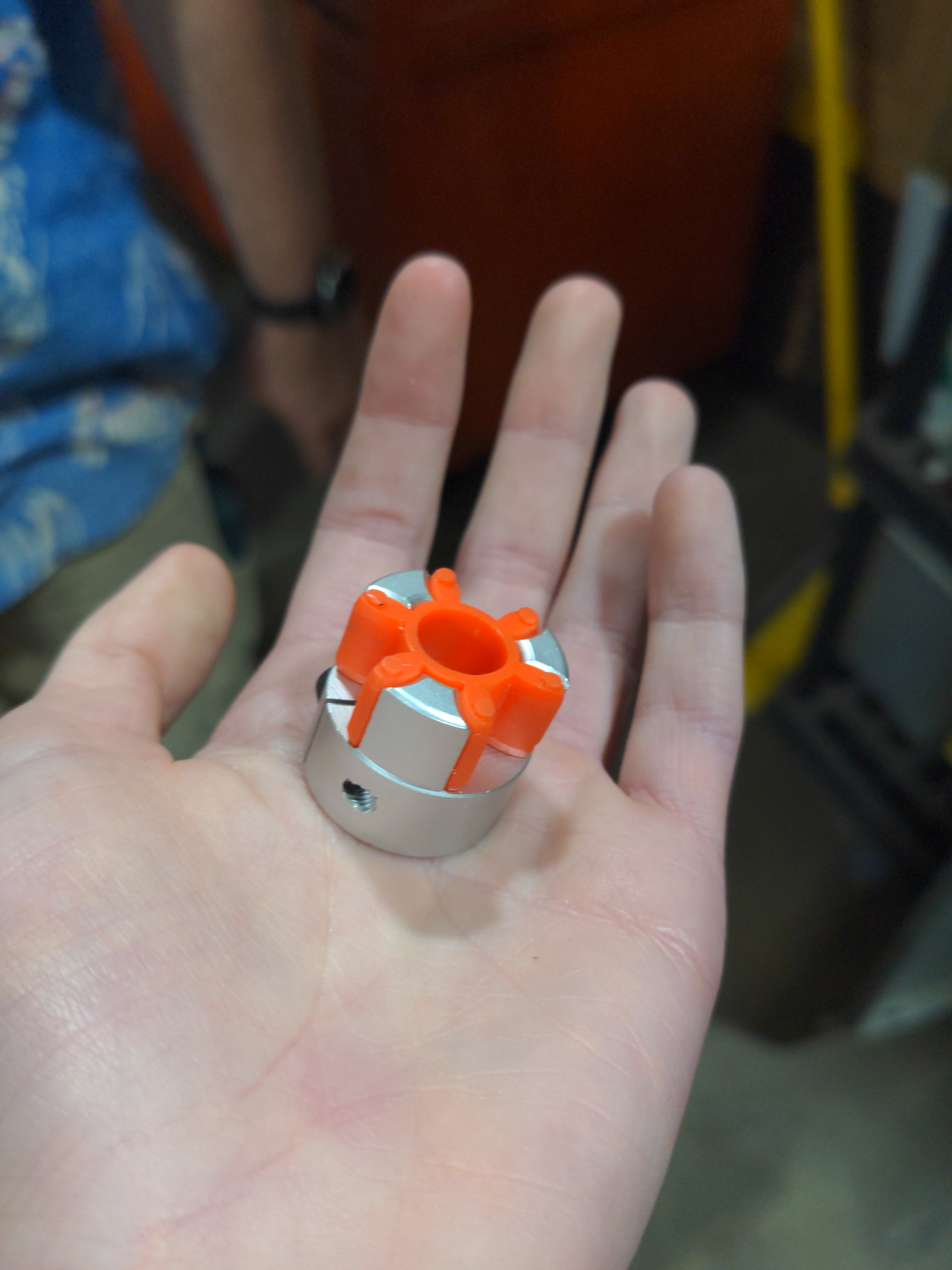

This looks like a loose shaft coupler to me. Make sure all of the shaft couplings are tight. On each of the axis drives where they interface with the ballscrew shaft tighten everything down. You may even want to apply some locktite, but I would start with just tightening them.

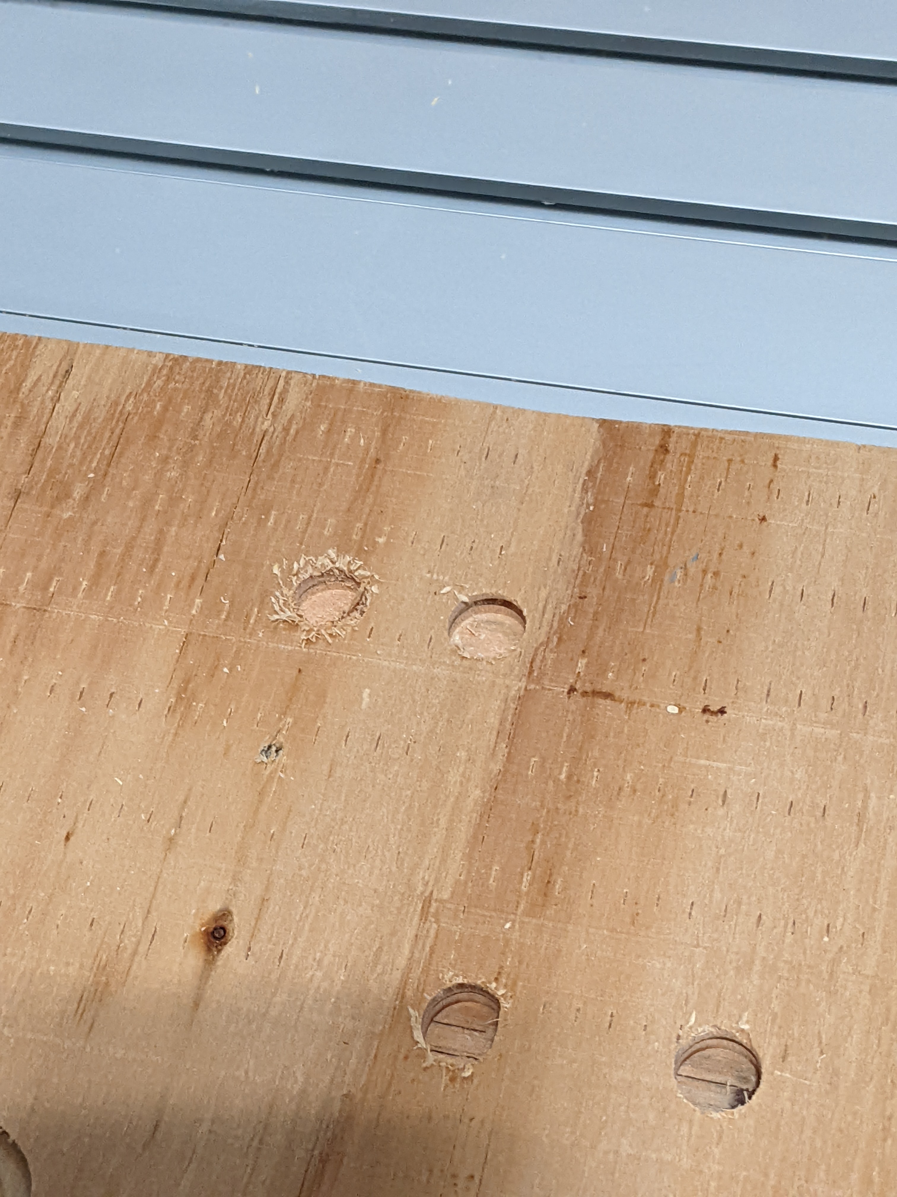

Made two half inch holes, with the edges an inch apart. Measured .915 on the calipers. Tomorrow will probably be tightening things down and doing this same test again and measuring the results.
Which post processor are you using in F360?
Also, on those holes you made, are you measuring the inside edges or outside edges?
Are the hole sizes under or oversized for what you expected?

Definitely looks like loose couplings to me. A downside feature of the Omio routers is that you gotta crank down HARD on those couplers otherwise they come loose and result in loss of positional motion.
Inside edges. Holes are .433.

This wasn’t supposed to just pull off by hand…
That should definitely NOT come off by hand. Pretty sure you found the culprit.
Yep. Thanks for the help! I’m going home for the night, still have an hour drive back to college ahead of me… Hopefully this fixes it.
I’ve found that some masking/whatever tape usually does the trick here. If you mic the couplers they’re usually a decent bit oversized for the screw (which means that the coupler is eccentric…the very problem it is supposed to fix)

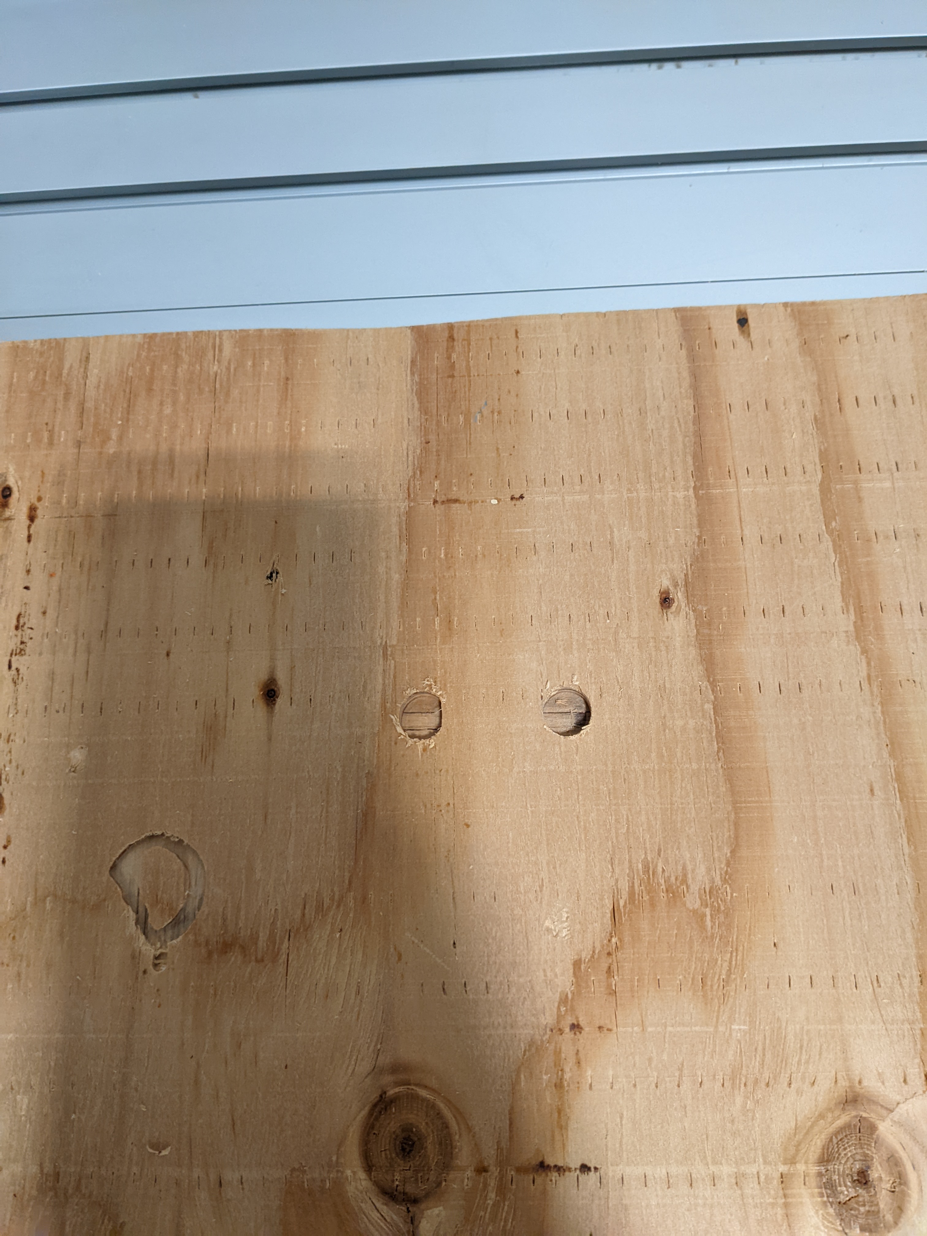

Huh. Fixed the part and reran the holes, now the difference between them is .44, no changes to CAD or CAM… I’m too tired for this lol
What should it be? Those at least look mostly round.
1 inch… Both sets of holes should be identical.
Center to Center?
Make sure to tighten the coupling on both the motor shaft and the ball screw shaft, and on all 3 axis. The masking tape trick @troy_dietz suggested is a good thing to try as well.
Inside edge to inside edge
Hard to gage from the image, but that looks larger than 0.44" between the holes. Are we sure the calipers are zeroed?
What is the diameter of the holes? What kind of profile is being used in CAM?
Zero’s and remeasured. .49. Still half of what it should be though. The ones below are .917, and they’re the exact same file.
