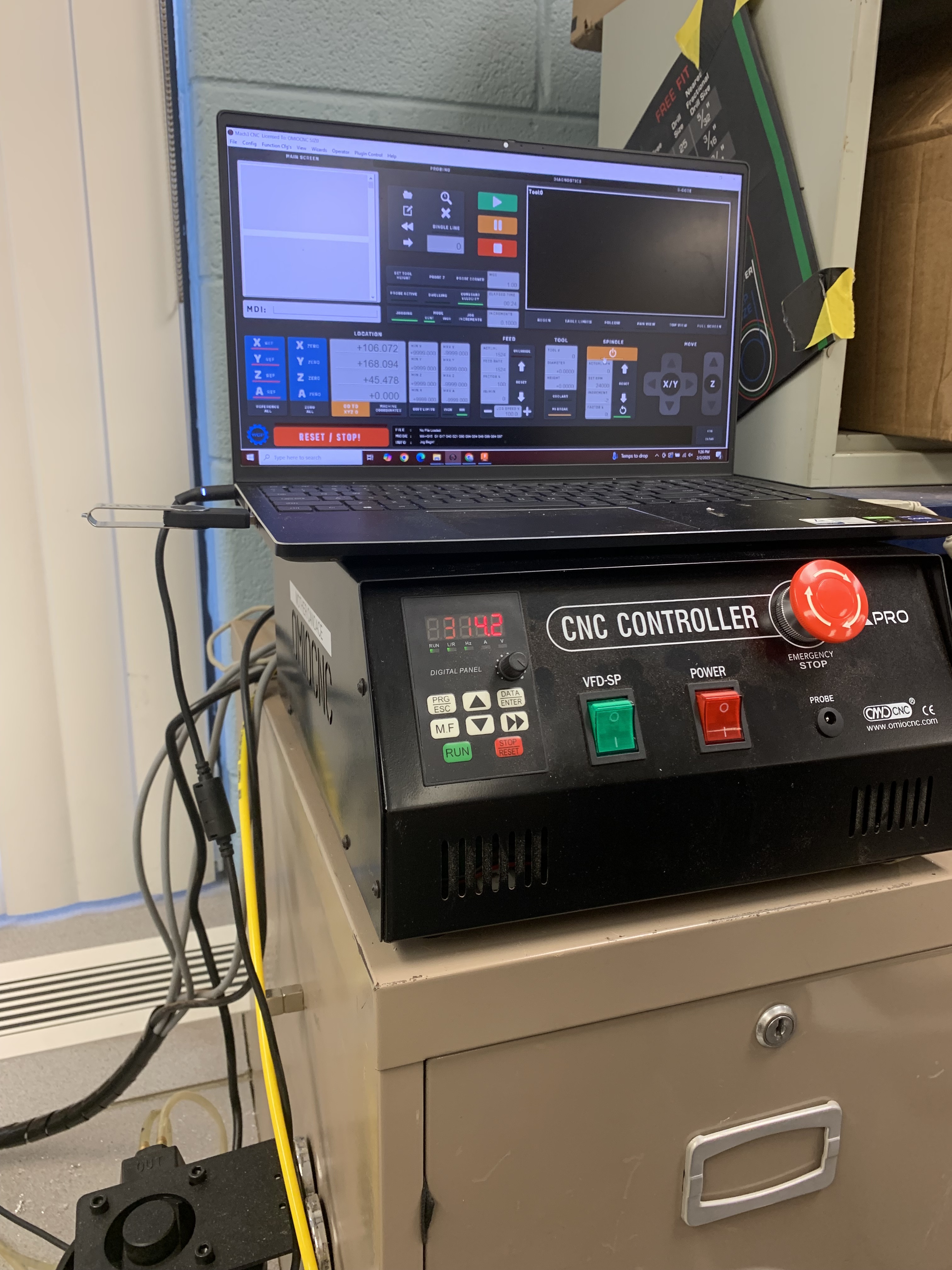

So I am having the same problem with X8-2200 at our school we are doing the initial setup and have ran into the spindle problem. So if I can get some help to find out if I need a new spindle. When I try and due the initial test run as the manual says M3 S5000 the spindle with start and the VFD will read up to around 70 and then will give ERR13 code and spindle stops

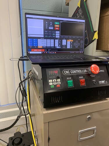

We have a similar issue, but our cnc wont spin up to full power, only reaching 314.2 instead of 400. Additionally, the spindle seems to make a slight squeaking noise when it spins up. Any advice?
Here’s a video of spin up:
